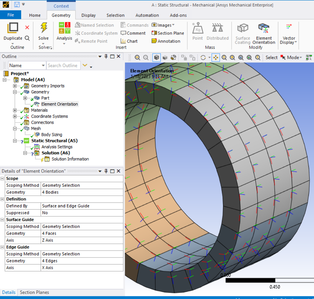

      How can I define a cylindrical coordinate system in ANSYS mechanical where the radial coordinate is the z axis in the cylindrical system? I am trying to model a homogenized composite system where the radial component is lower effective modulus than the z and theta (which are equal). When I try to run the model using the x direction as the radial component (conventional cylindrical system), I get an error for the elasticity matrix not being positive definite. I can make the matrix positive definite by switching z and x, but I do not see a way in mechanical to orient a cylindrical coordinate system such that it considers z to be the radial component. Perhaps this can be done with APDL commands. Alternatively, I'm open to suggestions for making the matrix positive definite with x as the lower modulus direction, but I don't see this as as possibility as this is a more fundamental constraint as opposed to the axis definition which I understand to be arbitrary.

      What release are you using? There's a feature that started being fully supported in 2022R2 that might work. I'll have to create a test case and send you screen shots of how it works since we're not allowed to send files through the forum.

      It's called Element Orientation (inserted under the Geometry branch in the tree:Note in the image above the the element coordinate systems have their blue (z) axes pointing radially. There are four 90 degree sectors in the geometry. The four faces that I used as a "surface guide" upon which the resulting z direction is based were the outer four cylindrical surfaces extending a full 360 degrees. The four edges I used as an "edge guide" upon which the resulting x direction is based where four cylindrical edges extending a full 360 degrees. Hope this helps. I did this at 2022R2. In earlier versions of WB you might have to resort to an APDL command object - tedious but doable.

      I am currently in 2021R2 but do have access to 2022R2 through my organization. I just haven't needed to update yet. Thank you for the pointers, I'll get an update going and try out element orientation.
