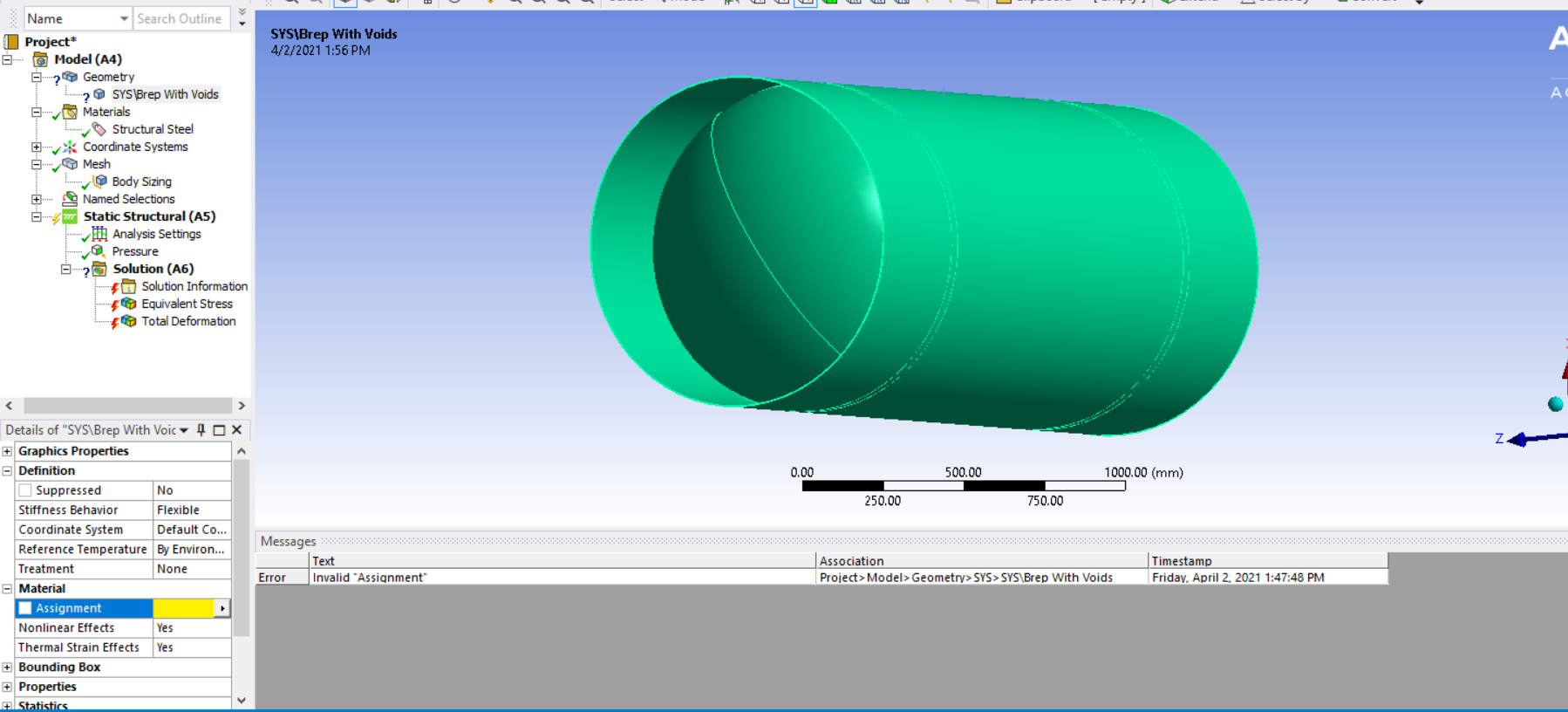

SubscribernUnfortunately, you cut off the Details window for the body in Geometry. That will typically have a field highlighted in yellow indicating the missing information. A common piece of missing information is the material assignment.nNovember 2, 2020 at 8:42 amrafa
SubscriberHey thanks for that. nI did not assign the material to the section earlier.April 2, 2021 at 5:59 pmJeremyS
Subscriber@rafa Unfortunately, you cut off the Details window for the body in Geometry. That will typically have a field highlighted in yellow indicating the missing information. A common piece of missing information is the material assignment./forum/discussion/comment/96019#Comment_96019
Im having a similar issue but the yellow box isn't allowing me to select any material. An also, does the green check next to 'Materials' in the tree mean that the material has been selected?n
April 3, 2021 at 12:58 pmpeteroznewman
SubscribernWhen you click in the pull down triangle at the end of the yellow field, do you see Structural Steel in the list? If so, you pick that and the yellow will go away.nViewing 4 reply threads- The topic ‘Question Mark near geometry in mechanical’ is closed to new replies.
