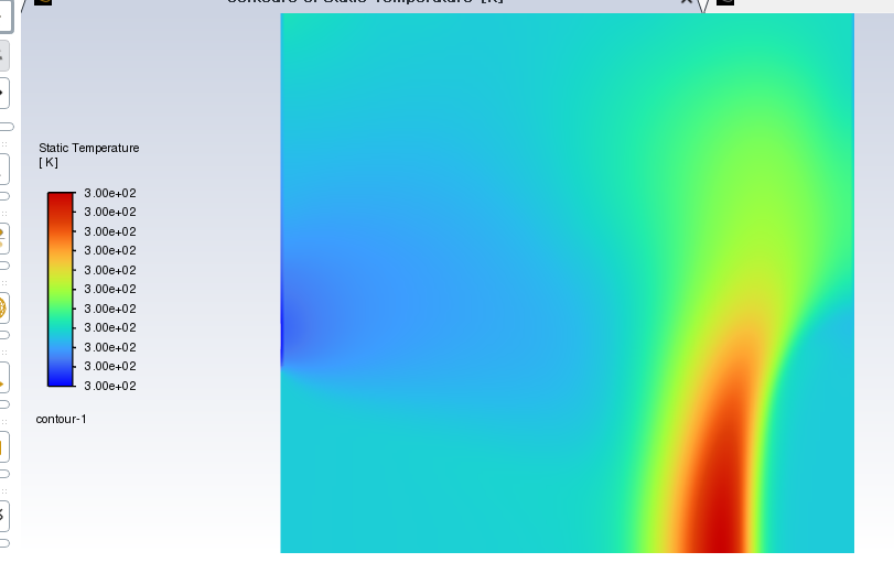

      I'm trying to figure out the actual mechanism of chemical species transfer combustion [H2/O2].
      Chemkin's "opposed-flow_flame/h2_air/chem.inp" was successfully applied, but combustion did not occur.
      This is simply a mixture of different substances in the air!
      [Main flow direction -> , <-]
      There are no errors, so why doesn't combustion occur?
      Current
      Chemkin file -> Non-mixed flame: Success
      Chemical species transfer -> Default file "Methane-Air": Success
      Chemkin file -> Chemical species transfer: Failure
      Reference link: https://ansyshelp.ansys.com/public/account/secured?returnurl=/Views/Secured/corp/v242/en/flu_tg/flu_tg_magnus.html
    • imjsh12
      Simple flow without combustion [direction -> <-]
    • imjsh12
      and chemkin .inp file

    • imjsh12
      I did it! I did it myself!
      It was just a simple solution.
      Physucs -> Species Transfer -> chemkin import -> turvulence ~ : check "Eddy-dissipation"! -> chemistry solver : check "Relax to" ~!
      I don't understand how the difference between "non ~" and "Relax to ~" modes in the chemistry solver options determines the success or failure of combustion.
    • Ren
      Some combustion models require numerical ignition to initiate combustion and some models do not.
      • imjsh12
        Oh, ignition factor.
         I hadn't realized this yet. I thought H2 could combust at room temperature, since it ignited at 300K inlet temperature in a chemkin.
         Haha, I looked it up and found that H2's autoignition temperature is 550K.
        Have a nice day.
    • SamW
      Yes, to add to what Ren posted, H2 in air at STP should not autoignite at 300K. Relaxing to chemical equilibrium can bypass (or substitute for) the ignition step, as you are not actually solving the finite-rate kinetics with this method. Please refer to the Theory Guide to read more about this approach.
      Because of the above, if you are seeking to incorporate the full kinetic mechanism in your solution you should switch to a different solver and/or combustion method after achieving this initial combustion - you can read more about the available options in the Theory Guide.
