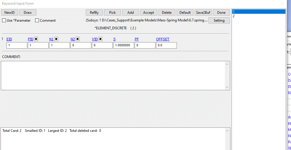

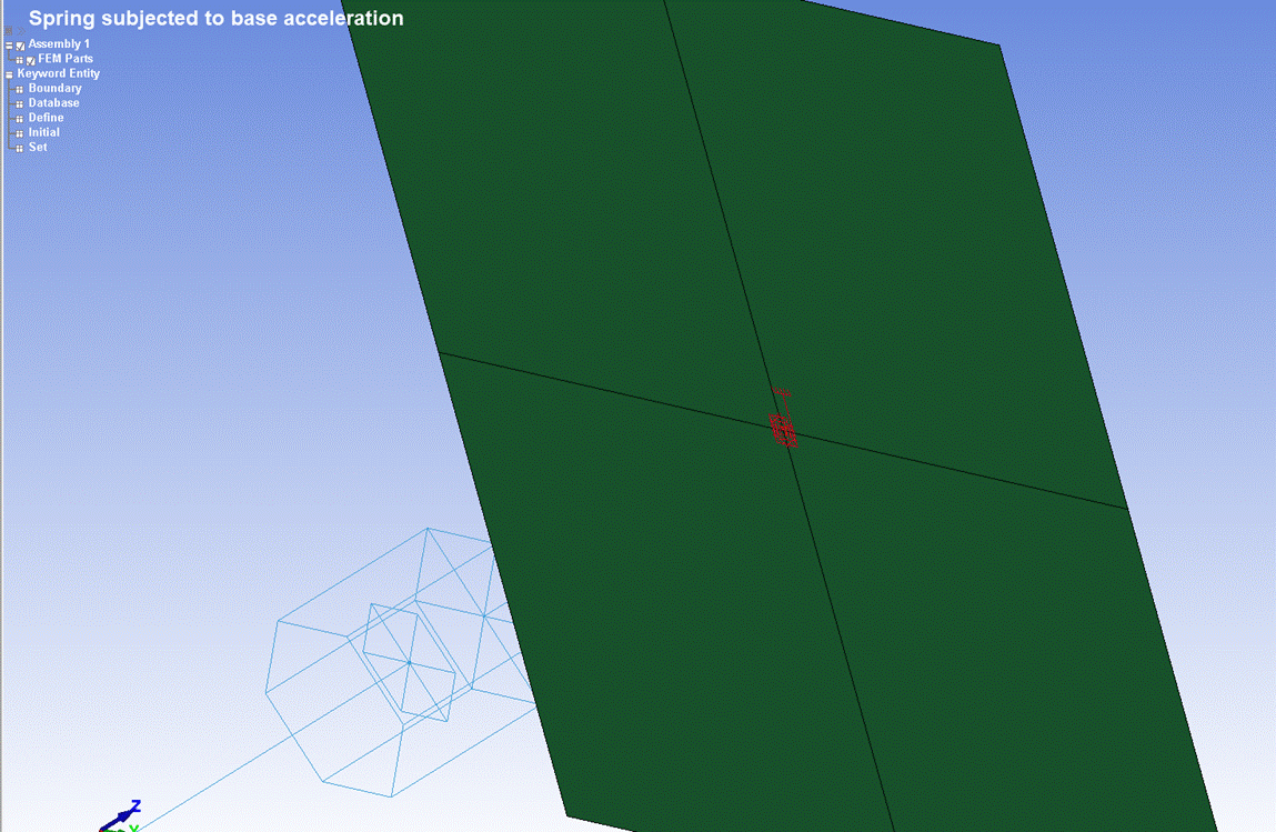

I had a question regarding the spring model for a Body-to-Ground connection. I was working on a simple test case where I tried to model a spring connected to a ground and used N2=0 in the *ELEMENT_DISCRETE definition to represent the grounded end.However, I noticed that the spring doesn’t seem to attach to a remote or fixed point. Instead, it appears to connect back to the body itself, which isn’t the intended behaviour.
Would you happen to have any suggestions or thoughts on what I might be missing or doing incorrectly?
Appreciate your time and help!
Looking forward to your response. -

SubscriberHi, check your section and mat card.  I can't look at the docs right now (at work) but there are options that let you define a body to group spring. Â
