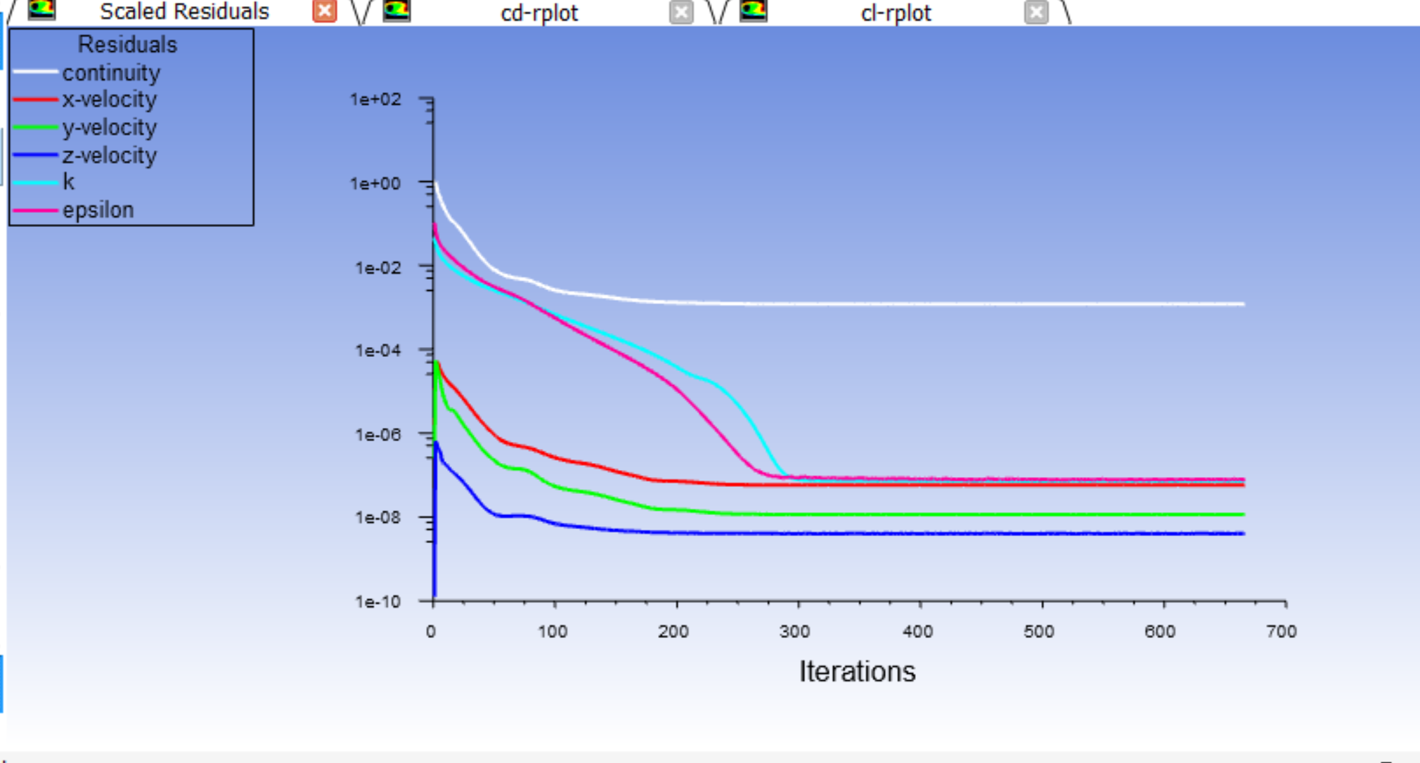

Subscriberhi. I am simulating a 3D foil in fluent.
after some iterations, the scaled residuals remain stable, as it is shown in below picture.
August 18, 2020 at 5:47 pmRahul Kumar
Ansys EmployeeHello, nTo know if a solution is converged or not, need not entirely depend on the scaled residuals. Also please refer to the monitors that you have setup and make sure they are behaving as they are supposed to. Another check would the flux balance, under Results --> Fluxes. nViewing 1 reply thread- The topic ‘question about scaled residuals’ is closed to new replies.
