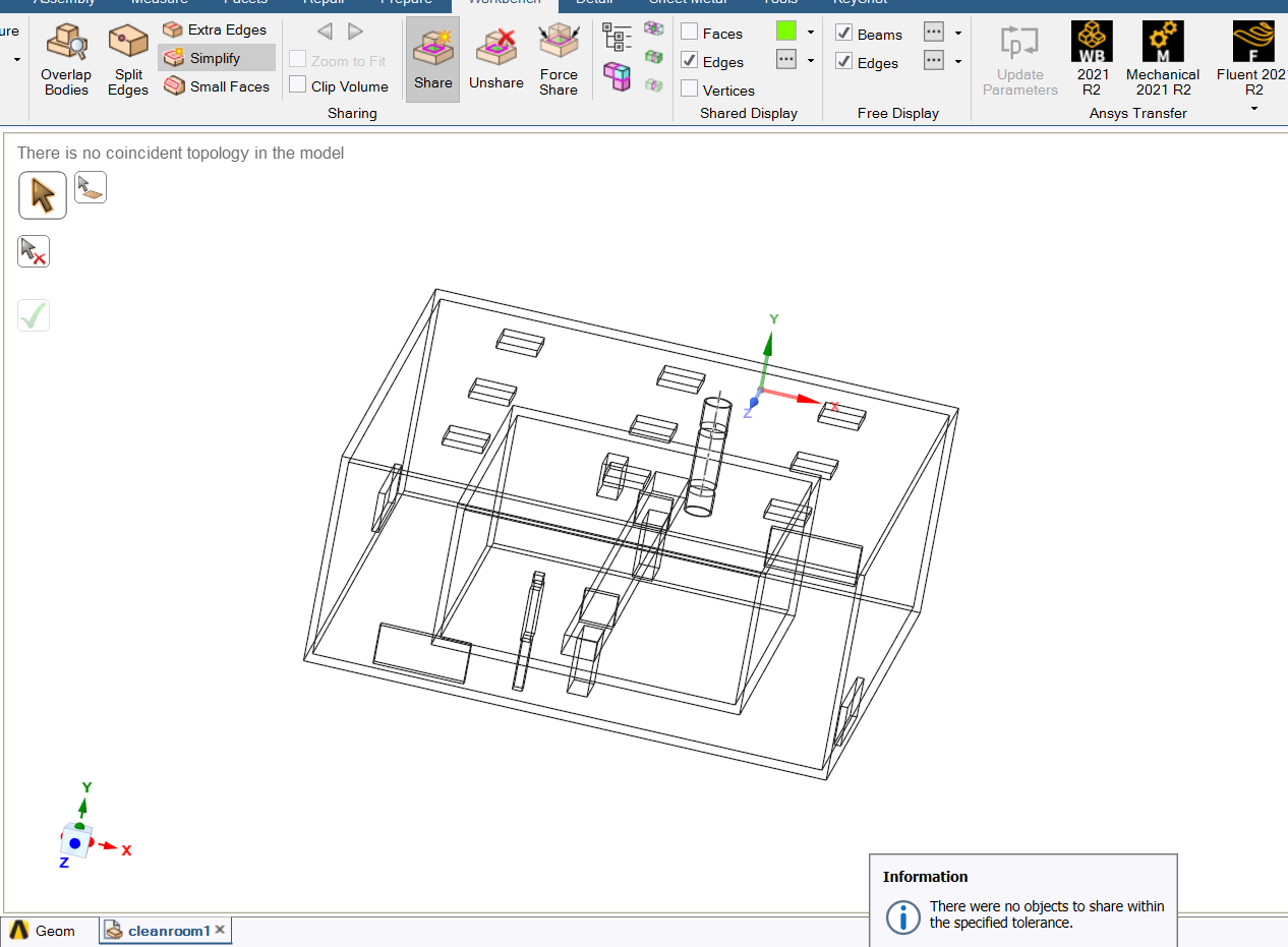

      Did you do share topology in SpaceClaim? It's possible you have duplicate faces which won't be handled in the Watertight Workflow.
    • cherlene
      No, I havent. I met this problem several time. I dont know how to share topolopy.
      When I clicked this, it shows there is no objects to share.
      Why are you modelling the walls like that? We just need the fluid region. Please can you show the component list?

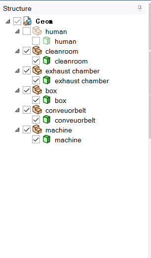

      Please show the tree, and also check you have a CAD volume for the main fluid region. A common error is to build the solid bits that we don't need and not build the volumes where the fluid will be.
    • cherlene
      Hi, Rob
      The structure tree is like this. Yeah, I understand that the fluid is the important part. but can I only build the solid bits and using fluent meshing cap function and choose the geometry only has the solid? I thought that after capping, the fluid is the space that enclosed by the solid bits.
    • cherlene
      Sort of, but if you read in the solids and have overlaps it gets messy. Go back to geometry and build a "solid" that is the fluid region. The naming convention in CAD is such that a volume is a "solid" but in Fluent we don't follow that convention as we have "fluid" and "solid" depending on what we're doing.
