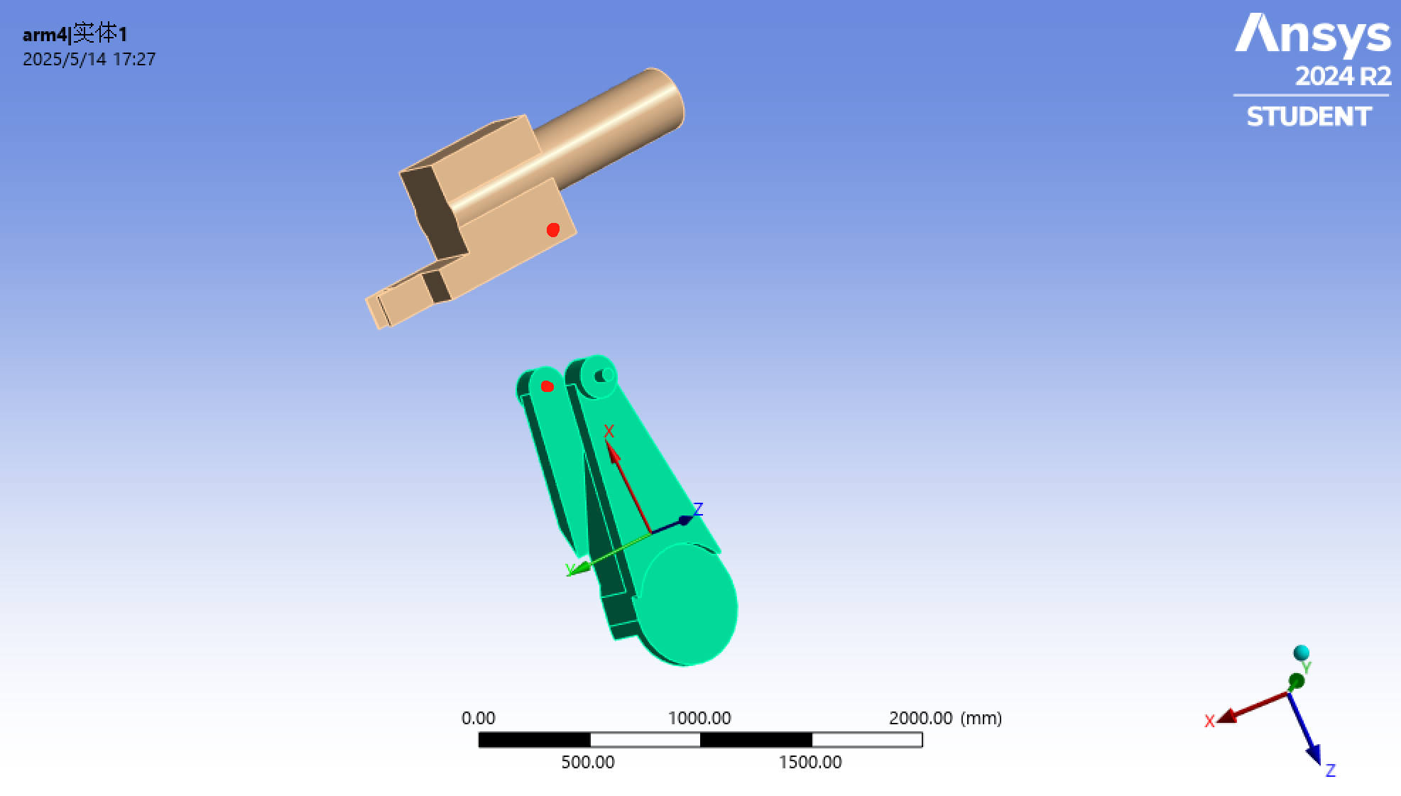

      I would like to create a coordinate system at a specific point on a component in Ansys Workbench Motion, but I don’t know how to create a reference point.
      I tried creating reference points in Fusion 360 and in Ansys SpaceClaim, but when I import the model into Mechanical, the reference points disappear.

      I tried to create a new coordinate system according to your instructions, but it doesn't seem to solve my problem. Let me describe my issue again: I want to establish a coordinate system at the position of the red point in the figure, so that I can select the correct rotation axis when creating a revolute joint for these two components in Mechanical. However, in my attempts, it seems that I can only select the center of mass coordinate system. Could you help me with this? Thank you!

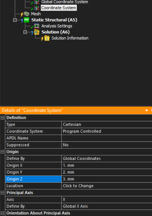

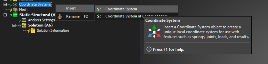

    • Ashish Khemka
      The following link will guide you to create coordinate systems. If you have a vertex at the above locations or if you know the x,y and z locations of the indicated point then you can easily create the coordinate system:
      Chapter 8: Coordinate Systems
