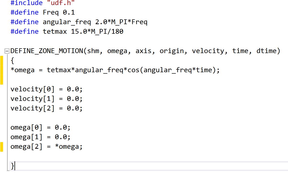

SubscriberI am trying to give the zone motion (Simple harmonic motion) using UDF in cell zone boundary condition. Below is the code attached. Though it shows no error on compilation, the zone does not seem to rotate as per code. Geometry is a simple 2-D closed-loop pipe and origin is at the bottom. Is there anything wrong with UDF? If any please suggest. Thank you in advance.

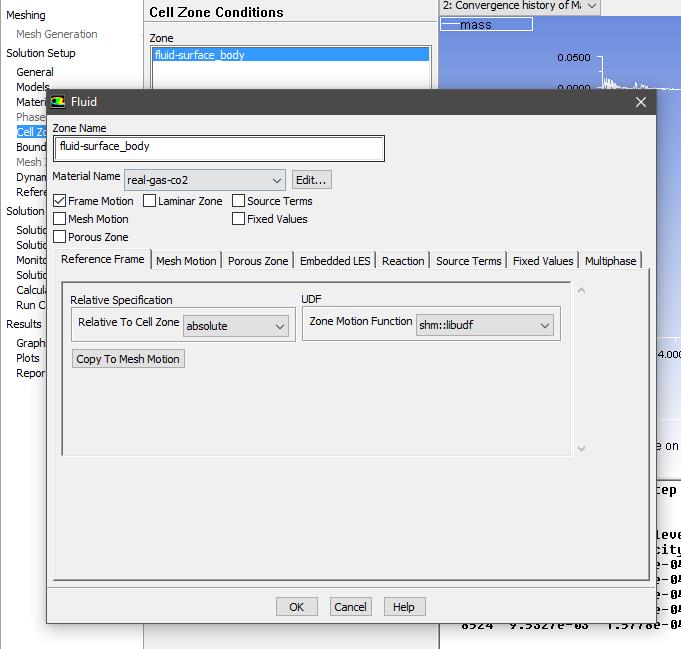

SubscriberYes, I did for four different cases.
1) frame motion with time period of 10 sec.
2) frame motion with time period 1 sec.
3) frame motion and mesh motion with time period 10 sec.
4) frame motion and mesh motion with time period 1 sec.
But the frame does not rotate as I see the animation. Now I come two conclusions, (i) whether my UDF is wrong (which is more probable), (ii) may be frame is rotating but in animation, it is not appearing to rotate (which would not be the case). The reason for taking four cases is to see the difference in the value of the mass flow rate for the different time periods. But in cases 1 and 2, there is some difference but the peak is nearly the same while in cases 3 and 4, values are the same.

Forum ModeratorJust re-read that: why are you using zone motion to define frame motion?

SubscriberIf there is no interface in the domain, is it advisable to use mesh motion along with frame motion? Because if I am using only frame motion then there occurs no motion in animation. While using a frame with mesh motion ...or only mesh motion, there is the motion as I can see in animation. I find no relative literature which relates mesh or frame motion without interface.

Forum ModeratorYou can't use sliding mesh without an interface. Reference frame doesn't require an interface as the mesh doesn't move. These approaches move or mimic motion of a fixed mesh. Ie a block of mesh may move but no remeshing takes place.
Mesh motion (moving/deforming mesh) doesn't require interfaces but does require remeshing.

Forum ModeratorThe terms have changed since this slide was written 13 or so years ago.
Frame motion - we move the reference so mesh is stationary.
Mesh Motion - we move the mesh on a (usually) set path but don't change the cells.

SubscriberOk so is that the reason that when using "mesh motion" we see motion in animation and in "frame motion", we see no motion in animation?
February 12, 2020 at 11:26 am
Rob
Forum ModeratorYes. Frame motion also means we can run steady state: much more efficient if we can solve in this way.
