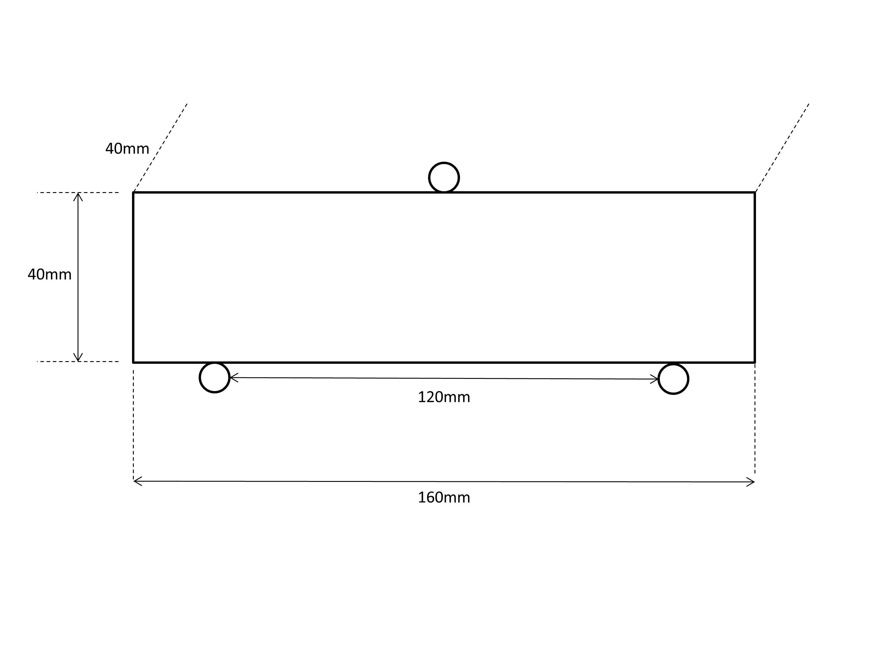

      I followed the discussion on Three point bending to design my model for static structural non-linear three point bending simulation with symmetry. The block size is 160x40x40 mm with a span length of 120 mm.
      For symmetry, I reduced the model to 160/2 mm (in length) and 40/2 mm (in width). I ran the model but I think I am mistaking somewhere either in symmetry or in boundary conditions. I would like to request guidance on the following queries;
      (1). Originally in the complete 3D design (without symmetry) I split the face to make place for the rollers (both top and bottom each with 10 mm of face split length). If I reduce the model length wise i.e. 160/2mm, I also reduced the face split of the top roller to 5 mm. Is it correct?
      (2). When I model symmetry, in the present case is the quarter model, I should apply the boundary condition load (displacement controlled) 1/4th of the original value. Will the resultant values (for force, deformation, stress, strain etc) will only be for the 1/4th of the model or for complete model?. I need to compare the experimental results with that of the simulation.

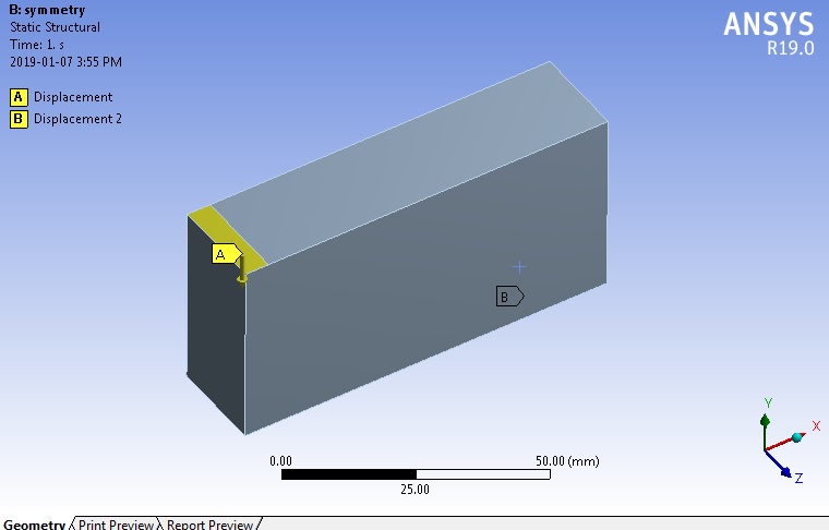

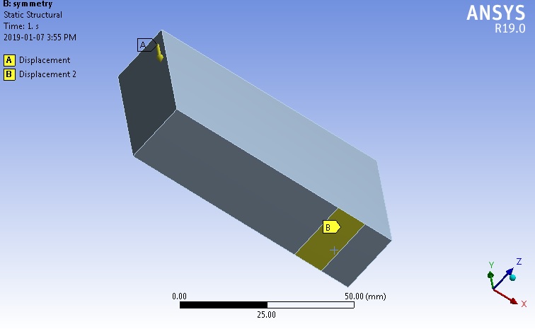

      (4). I applied the boundary conditions as following; with displacement A as x=free, y=-0.5mm, z=free. And displacement B as x=free, y=0mm, z=0mm. Could someone please correct me on applying the proper boundary conditions?
      With in the discussion the remote (loading) displacement was suggested. I am not clear about on how the rotations and components are decided to be set free or set as constant? Also, since I will be modeling the non-linear behavior so I shall keep the remote displacement behavior as deformable?

      (4) The problem with displacement on a face is the entire support face has to remain flat. This is an overconstraint compared with the real beam which has an angle change, especially at the end support. The Remote Displacement replaces the support face with a point and now the point can have Y=0 (at the end) and all other DOF remain Free so that the support face can have an angle change. The point will be created at the centroid of the face, but you can move it if you want in the Details window. You must move the point on the top load face from the centroid to the symmetry planes. Then the arrow will appear on a corner of the 1/4 model, but the load will be distributed to the top load face. There will probably be little difference in the results between Rigid or Deformable behavior for the Remote Displacement. Start with Deformable and look at the results.
      The benefit of Remote Displacement over contact is that RD is a linear constraint, meaning that the solver can compute its solution in one iteration, while contact is a nonlinear constraint and the solver must use multiple iterations to compute the solution. You have material and geometric (Large Deflection=On) nonlinearity in the model, so the solver will do multiple iterations anyway. There may not be a large difference in solution time, but you have to do more geometry prep for contact, since you need to create the surface on which to make contact, and then add support to that surface and deal with potential convergence problems in the contact.
      If the supports are at a fixed span, contact is more accurate as jj77 explains, because the beam will pull inward as the center fails, and the contact point on the beam will slide closer to the end as the beam pulls inward. The RD point will move inward with the beam, which is a small error in the model compared with the real model, but this is a second order effect for small -y center displacements. I prefer to use a simpler model and get a result with the first order effects, then add complexity to look at second order effects in a second model.

      One last query before I mark the solution. I have kept the remote displacement for the support at the default centroid of the face at the bottom.
      But for the top face the default position of the remote displacement was as following,
      I selected one of the symmetry planes (total I have two symmetry planes) and I had the remote displacement being shown as the following,
      According to the guidance, the point shall appear on a corner of the 1/4 model. But for me the point is being shown outside the 1/4 model. How shall I adjust it manually or it is at the correct position already?
      You should adjust it manually. If you set the geometry filter to Vertex, you can click on the corner of the body at the center planes. On the bottom of the Mechanical window you will see the x,y,z coordinates of that vertex. Go to the Remote Displacement, in the Details window edit the Coordinates to the correct values.
