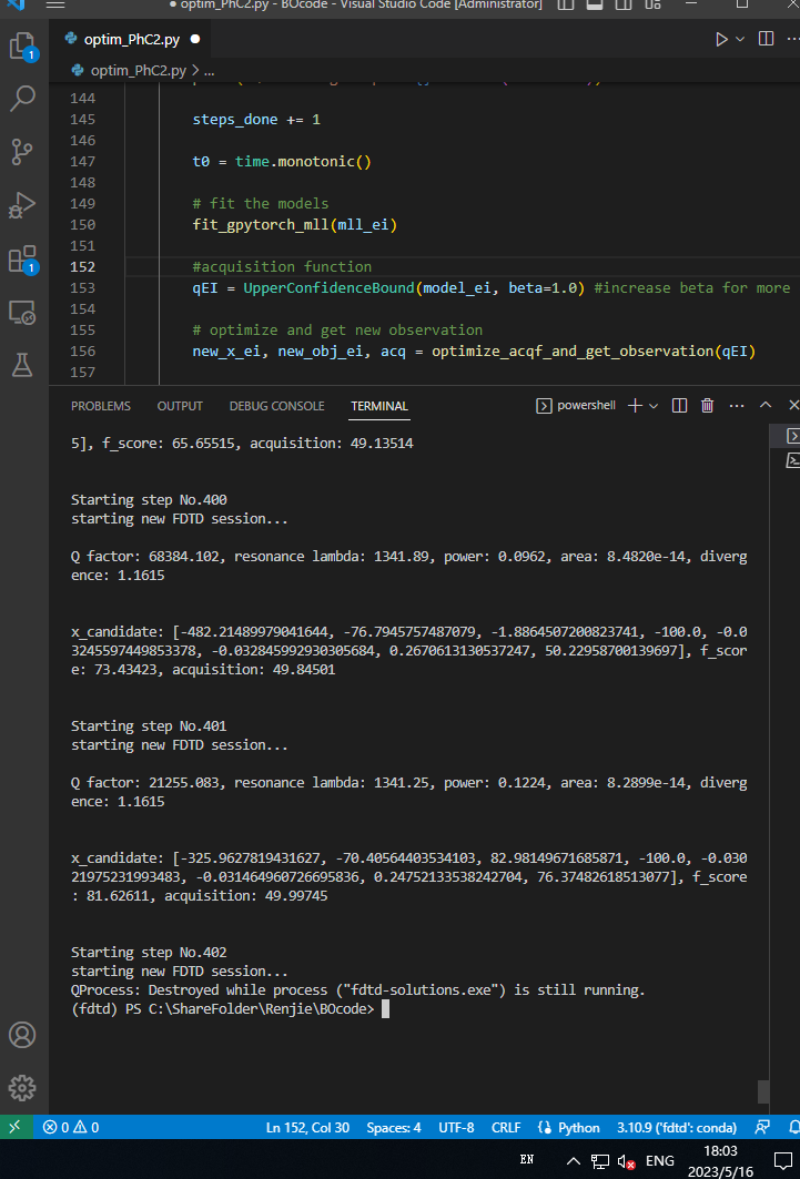

      When I use FDTD lumapi to run some optimization algorithms in python, the error "QProcess: Destroyed while process ("fdtd-solutions.exe") is still running" would sporadically pop up and terminate my program altogether.
      I'm not sure where this error is steming from or what it's specifically related to. Any ideas how to avoid/fix this?
      Thanks.
    • Zhaoyu Zhang
      Please see above image for the error. The "QProcess: Destroyed while process (“fdtd-solutions.exe”) is still running" error can be seen at the bottom of the image. This error fatally terminates my optimization process while running fdtd via lumapi.
      Any help woule be appreciated!

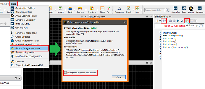

        Try to run this sample API script (i.e. save as 'lumtest.py');
        import lumapi
        fdtd = lumapi.FDTD()
        fdtd.addfdtd()
        fdtd.addring()
        fdtd.addmesh()
        fdtd.save("lumtestpy.fsp")
        from the "CAD > Script file editor" window. With Python Integration showing "Active". (see image)
        If it works and runs to completion, it will save the file, "lumtestpy.fsp" on your current working directory (cwd).
    • Zhaoyu Zhang
      Hi Lito, yes your sample code worked and saved the test file. How is this related to the QProcess error?

      @Zhaoyu Zhang,
      Does the error happen when you run the script in the CAD or only when you run from the other application? QT is used by “lumapi”. Which version of Ansys Optics/FDTD are you using.
      • Zhaoyu Zhang
        Hi Lito,
        The error only occurs when I run in my python IDE. My version of FDTD is 2021 R1.4.
        I did some deeper searches on the internet and found that the QProcess error could be connected to the GUI or multi-processes computing. But i'm not sure how that would translate to my problem.
        Actually, I can think of a possible reason why this error occurs. I'm using a windows software called "clickoff" that detects pop-up windows and automatically clicks buttons on the pop-up window to close it (https://whatsoftware.com/auto-click-annoying-confirmation-buttons-clickoff/).  "clickoff" is used by me to automatically detect and close the "select frequency" window when I run the field and power monitor (DFT monitor) in FDTD, where it would click the "ok" button to close the window (see image below). Do you think the error could have been caused by using the "clickoff" tool?
