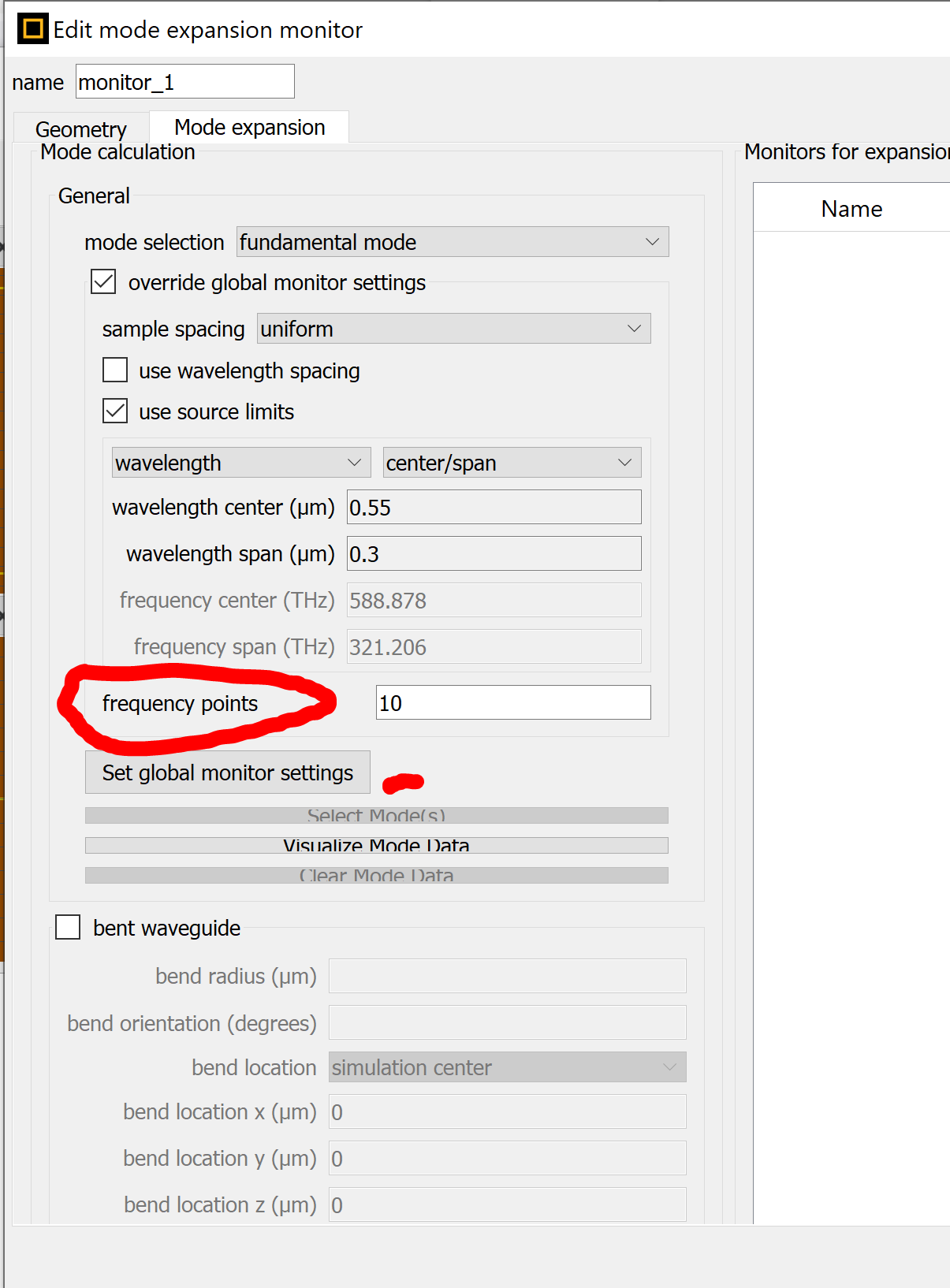

I am running a FDTD simulation of a waveguide with dipole source (broadband). I am estimating the amount of emission coupled to the fundamental TE mode of the waveguide at each wavelength. I am aware that the dipole power needs to be normalized to account for the purcell enhancement in a non-homogenous medium. I am using the ratio (dipolepower/sourcepower) to normalize. But when I do a broadband simulation, there are certain wavelengths for which the transmission is larger than 1 which is physically not possible. Is the normalizing factor accurate? Is there any other approach for broadband simulation?

Did you divide the transmission by the Purcell factor (dipolepower/sourcepower) or multiplied it? It should be divided. If the result is correctly renormalized, there might be two causes:
1: the dipole power may not be accurate when the dipole is located in lossy material, or in small mesh size. Please search dipolepower in Lumerical website to get more information, as the current forum has difficulty with a website link.
2: When you use broadband dipole to extract excited mode information, caution ay be taken that, the mode profile is frequency dependent.
I guess your result might be related to the mode profiles that are at one frequency but the decomposition is for broadband.
June 24, 2022 at 4:59 pm
Guilin Sun
Ansys EmployeeFor #2, please use mode expansion monitor and set the recording frequency to be broadband.

I was unable to find the setting "set the recording frequency to be broadband" in my mode expansion monitor. It would be helpful if you could share a screenshot of the settings window where I can find that.Â

Ansys EmployeeFor Purcell factor, if you use the result from the dipole source, or using dipolepower/sourcepower, when the mesh is finer, or the dipole is located at a lossy material, the analytical dipolepower is not accurate: https://optics.ansys.com/hc/en-us/articles/360034925293-dipolepower-Script-command
You will need to use box monitor to modify the actual dipole power. If it is in lossy material, the box monitor dimension needs to be carefully set: too large the dimension will lower the actual radiated power due to abosorption; too small the dimension may affacts the accuracy of power integegration.
As for the mode expansion monitor, there is a box "frequency points" where you can specify the number of frequency points to match those in DFT monitor. Sometimes the forum does not accept the image so I will try to paste it in next reply.
