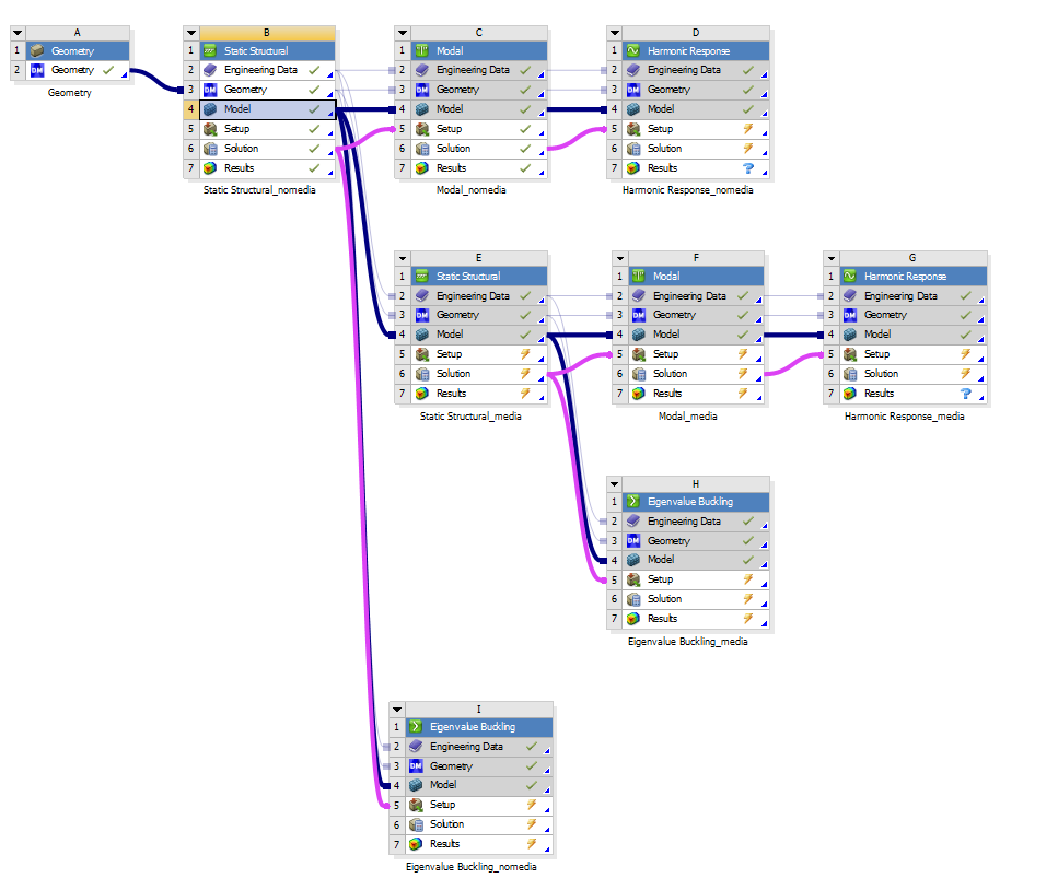

SubscriberI have this multiple system project in workbench 2021R1 which I have been re-doing for the past 5 times. Every time I finish the analysis, obtain result and save the project and close the mechanical window, I see the model in B (static structural) going back to the version I had done two weeks ago. Which means I need to solve everything again.
I saved the project at a different location in a different name using "save as" option; but the same problem appears(the same old model).
Is this happening to anyone, what am I doing wrong? Could somebody help me get out of this loop please?

Ansys EmployeenHellon A bit of a long shot here..nOne thing you could try quickly is to clean the settings:nExit Ansys completely.nStart > RunnOr, in the Explorer address fieldnEnter: %APPDATA%n...An Explorer Window will opennOpen the Roaming folder...nOpen the Ansys folder...nRename the vNNN folder to vNNN.oldn (v211= 2021R1, v202 = 2020R2, etc)nStart WB and try editing / saving etc.nLet me know if this works.nViewing 1 reply thread- The topic ‘Project crashing’ is closed to new replies.
