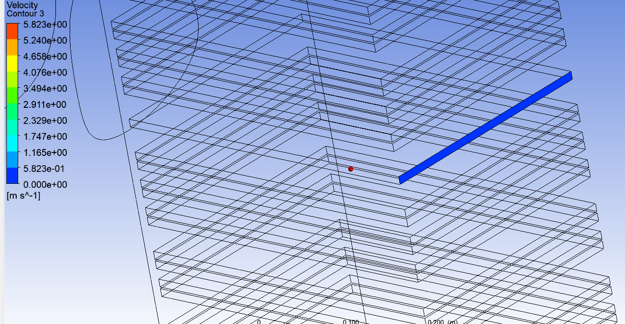

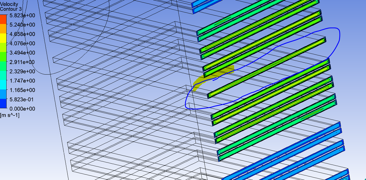

      I have created the user surface but CFD post doesn't show the data on the surface by default.
      It shows zero velocity everywhere on the user surface
      But the actual velocity contour on the surface is as follows:
      Why the user surface data is not shown by default?
