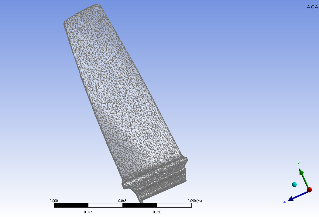

I am working on a blade geometry, I have a problem when reading the geometry in the design modeler it is shown like a mesh.
The problem that I can not select a surface that way.
April 20, 2022 at 8:51 amErik Kostson
Ansys EmployeeHi
Use SpaceClaim to convert to solid - hope the below video helps.
(See the Facet tab and the Tools tab in Spaceclaim - these tabs/tools are often used for converting stl/mesh type of geometry to solids, just as shown in the video)
