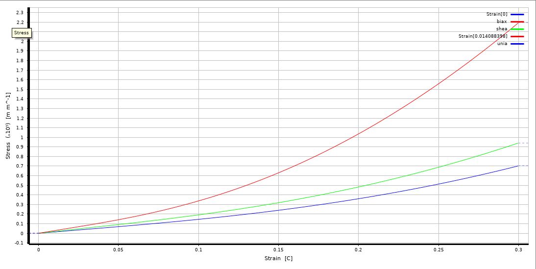

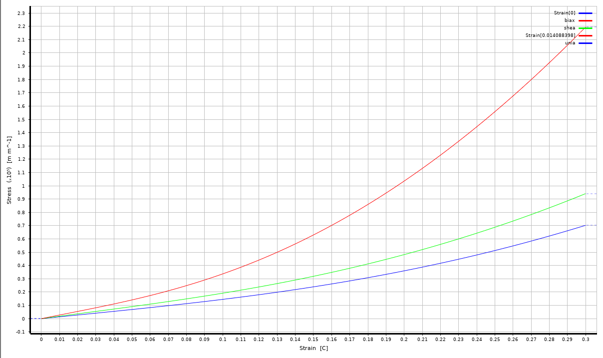

I was doing a simulation on hyperelastic material by curve fitting. I only have biaxial test data. Here, I put the test data including lateral strain. Further I am curve fitting it to find the respective constants for the material model. The problem is that when I see the curve as shown in figure below. The curve is plotted for stress (m m^-1) and strain (C). The units are wrong. Can anyone help me what it is trying to represent or is there something wrong with my setup?

Ansys EmployeeIt looks like you have added your strain values in the temperature column (hence Celsius) and stress in the strain column (hence m m -1). Leave the temperature field blank and insert just the stress strain data. This https://www.youtube.com/watch?v=K0rIwPEi0mg tutorial will help you with the curve fitting process.
Regards Ishan.

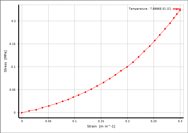

Further I figured out that when I use biaxial test data with "Has lateral strain" option set to no the graph becomes correct as shown below
But when I use Biaxial test data with lateral strain the as shown in above post the units of the axis are wrong. Can you please tell me why I am getting the wrong graph with biaxial test data with lateral strain. I have also attached the archive file for the reference.
