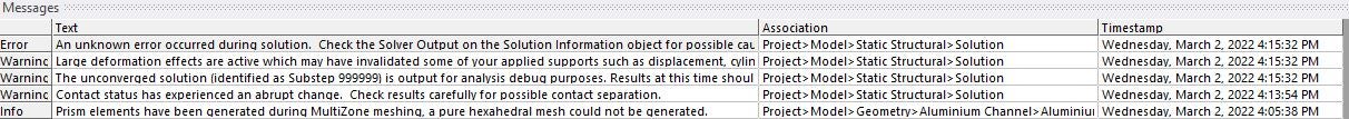

I am doing a prestressed Explicit Dynamic Analysis Where the results of bolt prestress in Non-Linear Static Structural is used as setup of Explicit Dynamics (Workbench Autodyne). When I am Trying to Solve the Static Structural simulation I am getting the following error.

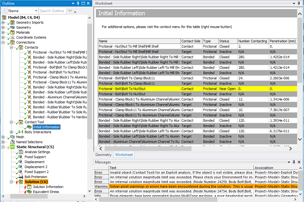

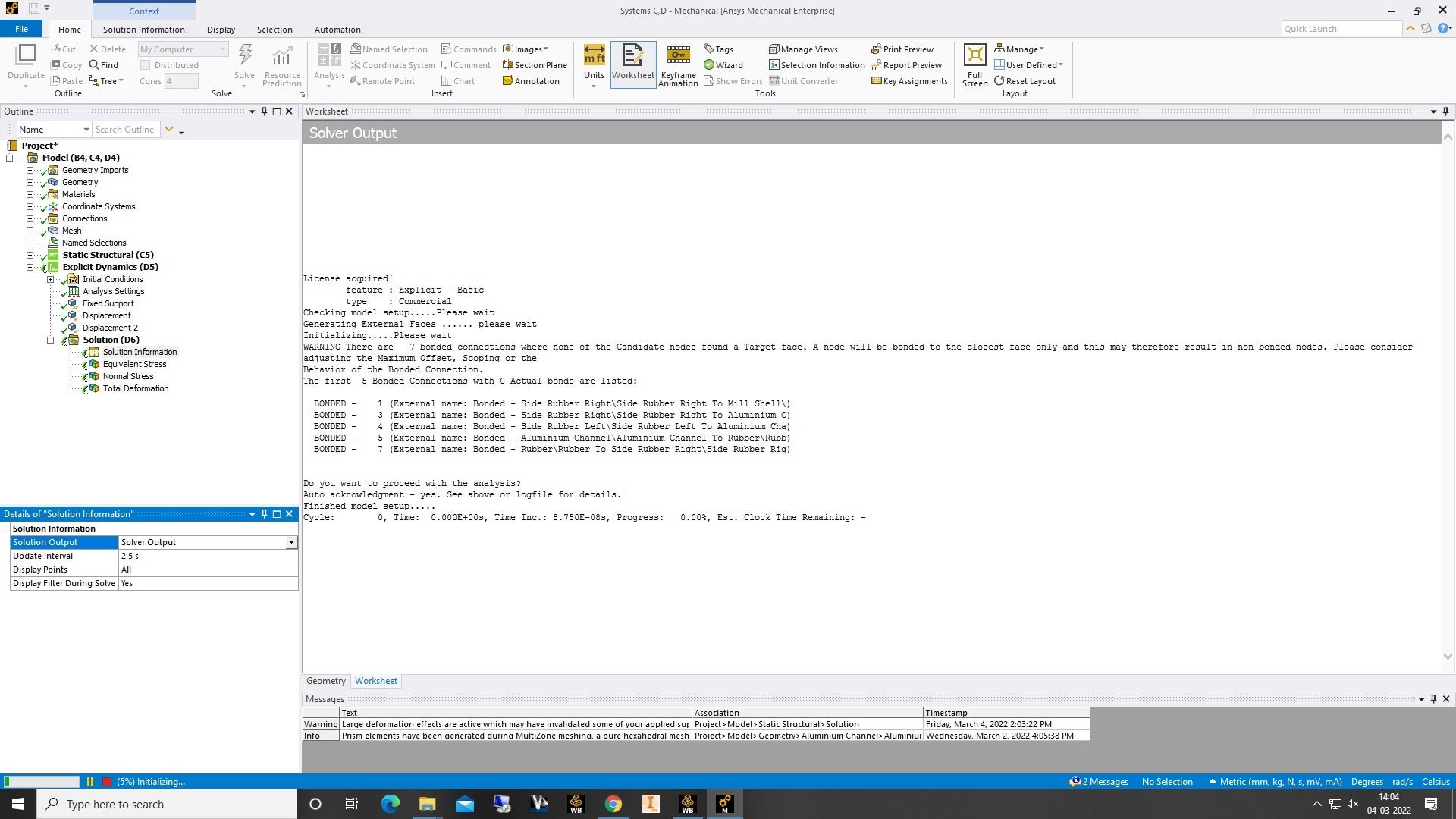

First of all I am getting the Warning related to several Bonded Contacts that I have used in Static Structural Analysis. The images of the warning is attached below.

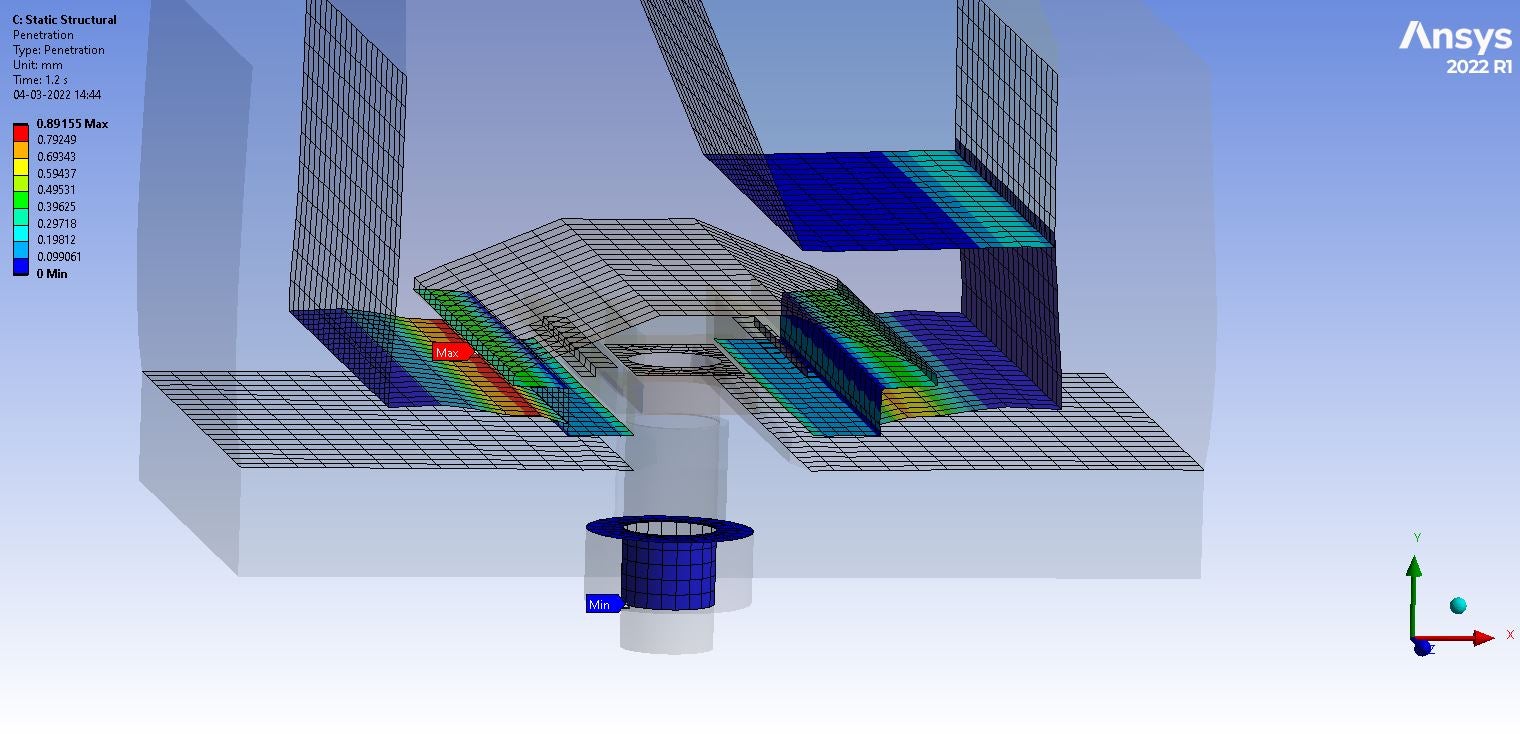

From the deformation plot of Static Structural Analysis it can be seen that there is 0.8 mm of maximum penetration between the rubber. Is that causing these warning message? I have attached the image of the penetration plot below.
To eliminate the penetration, I have tried to change the formulation of the bonded contact to Normal Lagrange. But in that case Static Structural Simulation is not converging.

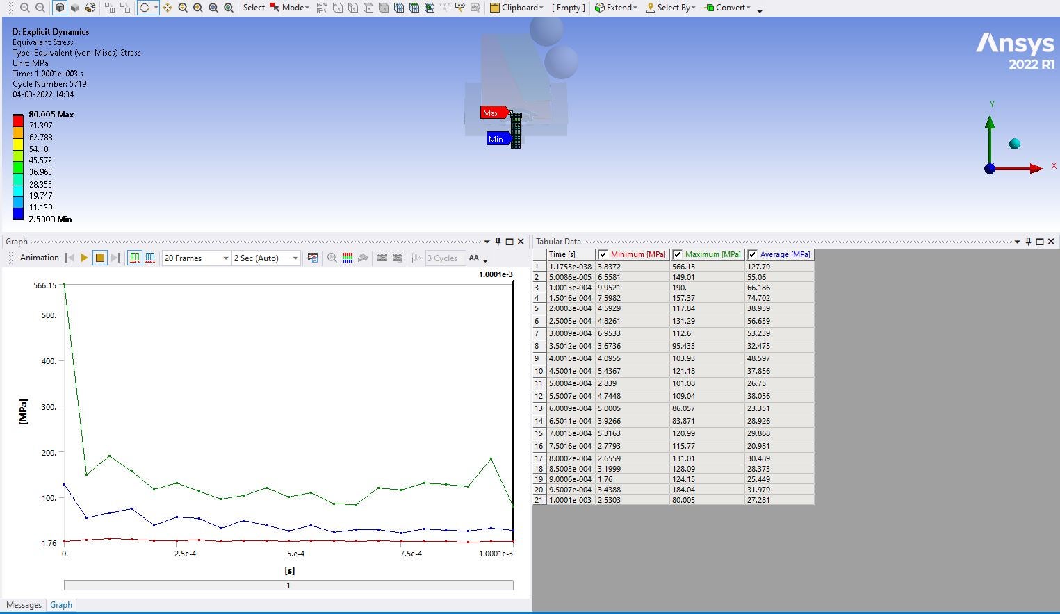

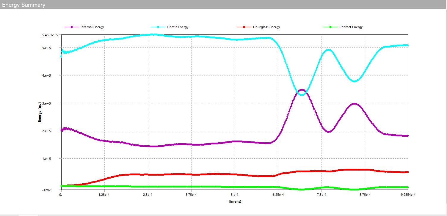

Secondly the stress in the bolt should increase from Static Structural result when the impact occurs. But the stress result I am getting is unrealistic. The max stress is at the start of the explicit simulation and then it just fluctuates. The images is attached below.
Also the Kinetic Energy of the System should be constant before the impact since only the ball is moving with a constant velocity. But that is also fluctuating as shown the below image

March 4, 2022 at 1:26 pmpeteroznewman
SubscriberStep 1. Replace all Bonded Contact with Shared Topology. In Mechanical, delete all Bonded Contact. Open the geometry in SpaceClaim. Put all the parts that are to be bonded together into one Component. Open that Component, go to the Workbench tab and click the Share button. Now in Mechanical, meshing will connect parts using shared nodes at the interface. The only contacts are Frictional.

Now the displacement as well as the stress plot is that I am getting is very strange. The Bolt is splitting into two and going upward from the plane which I had specified during the Static Analysis to apply the bolt pretension. I know that the bolt pretension object splits the bolt shank into two and pulls them towards each other in order to apply the pretension load. But I have no clue why this strange phenomenon is occurring in explicit dynamics. I have attached below the images of the displacement and stress result of explicit analysis at the end time. I cant paste the images in the comment box for some reason. So I am adding them as attachment.

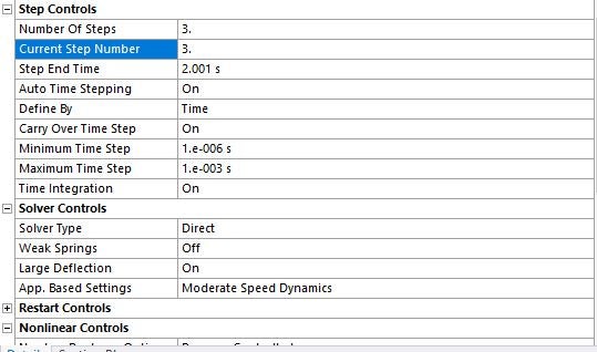

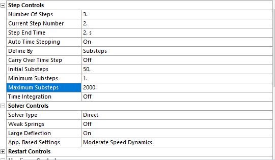

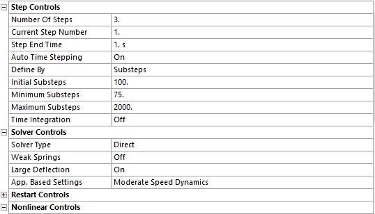

The initial Velocity of the ball ranges from 10m/s to 15m/s depending on the various design parameters. Actually I do not know how to run static simulation in transient dynamics environment and that is the issue I am facing with model you have provided. The same model that converged in static structural analysis now is not converging in transient dynamics system.
I have unsuppressed the bolt pretension and turned off time integration from Load Step 1 and 2
. I have the following settings for the first two load step (i.e. Bolt Pretension and Lock):
Load Step -1
Load Step-2
Load Step -3 I did not change the Time Step that you originally provided. I just changed the end time.
But the load step 1 and 2 are not converging and giving me element distortion error.

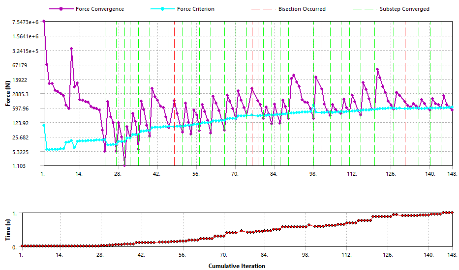

SubscriberHi Peter. I actually managed to solve the problem. The issue of Non Convergence in the implicit part was due to the fact that the bolt prestress load was being applied in stepped configuration. That was needed to change into ramped configuration. To do that I inserted a command object with kbc,0. This set the load application into ramped configuration and the implicit part converged without any issue.

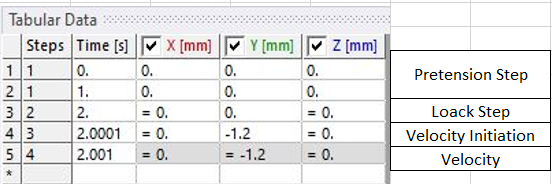

Regarding the application of velocity I looked into the Mechanical User Guide. For my case I inserted two additional step (After the Bolt Pretension Step and Lock Step). My complete load step looked like following image :
But the trick is I need to deactivate the last load step so that the ball moves freely in Y direction with the velocity defined in "Velocity Initiation" step, which in my case is 12 m/s. With this method the analysis completed without any issue.
