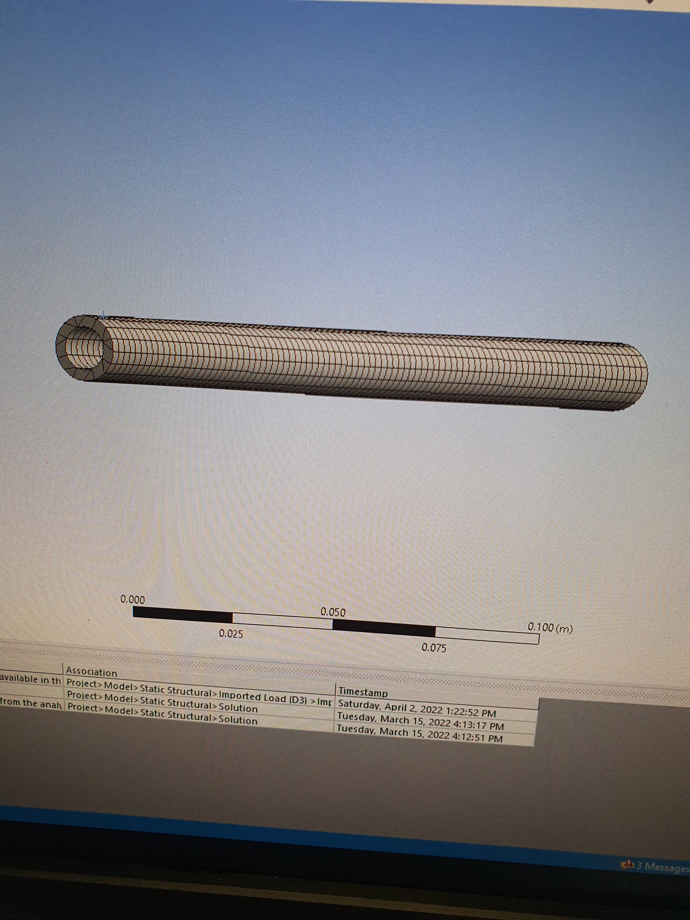

I have a pipe with inside and outside fluid flow. I tried to make one mesh for solid and fluid parts but I couldn't. So I made two separate meshes for solid and fluid domains. I got the run in fluent, but when I want to import the pressure to structural, I can not select the whole solid domain as geometry (in imported load) Only surfaces can be selected and finally I get an error.
I've attached the images of my meshes. Could you please help me in this regard?
Thank you very much!
April 13, 2022 at 6:01 amRahul Kumbhar
Ansys EmployeeThe pressure can be imported on surfaces only. Do you get the error while solving? Its probably because no constraint.
