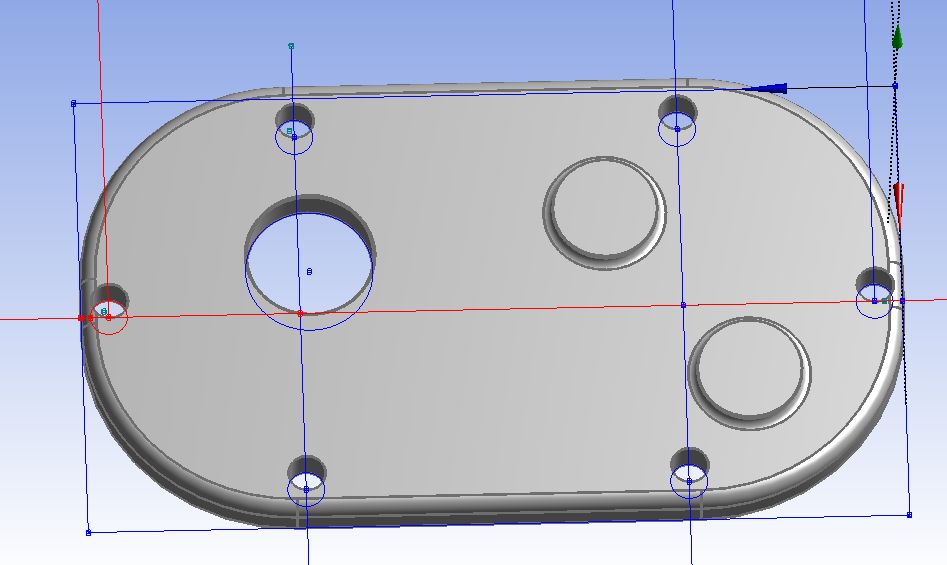

      To simply add material "to the holes," sketch circles of the needed material diameter at some height above the part and extrude them into the part, filling the holes (and obviously centered on them.) Then re-cut the holes at the larger size, and chamfer the top edges to make the conical bits -- or sketch the exact new hole+chamfer profile and rotate it. You will likely want to add (small) rounds at the intersection of your added material and the base part.
      F
      Add an axis on the hole center and add a plane through that axis. On the back of the part, draw a circle that is on the hole center, but is slightly bigger than the part and extrude that circle up to the front face. You will fill the hole, but you will have the bulge that is outside the part, especially the edge blend.
      On the plane that goes through the hole center, you can sketch the profile to revolve around the axis that will cut the hole, the countersink and the cone, all in one cut operation.

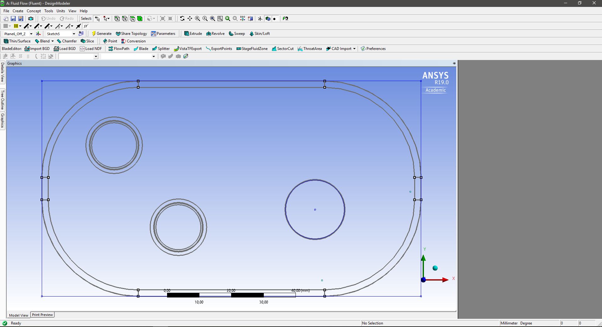

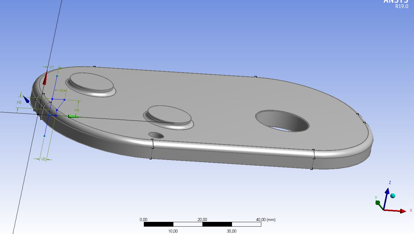

       So just can give you some vision of my model, however I am not able to do what you did, i. e. I cannot do the cone and hole at all, it does not work and need to learn it how to do this.
      See here the picture of the model, again impossible...
    • Georgiro
      There is some stupid problem I have during the modellation, but I have no idea what is the problem, thanks for giming me your ideas. Jiri

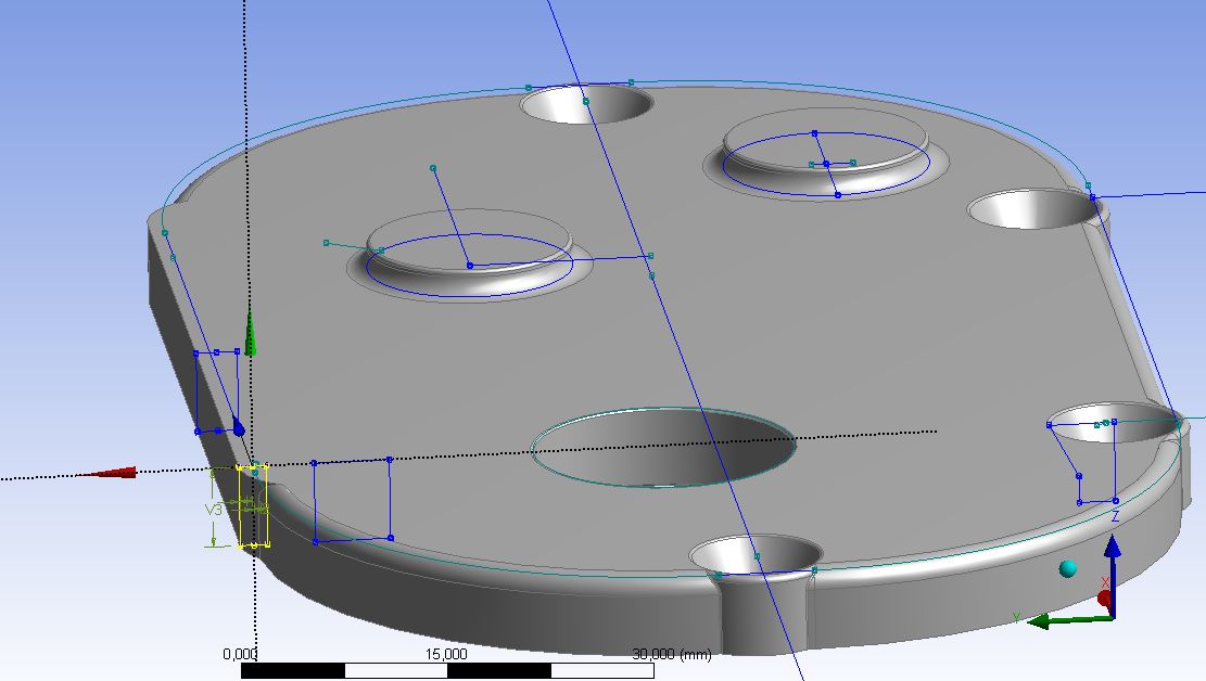

       Hello, I would like to ask you if it is possible to change the operation in time, i. e. to change their time dependent operations to construct, the point is that in the model I have made I have not done some special casted volume as shown in the picture, but I need to put it to the middle of different operation, because I need to make the holes for the bolts afterwards, so the point is, how to do it before the holes will be done? Thanks, I have no idea how to do it.
      In the history tree of features in DesignModeler
      You can RMB on a feature and Suppress & All Below.
      Then you can RMB on that first suppressed feature and Insert a new feature.
      When you are done, RMB on the first suppressed feature and select Unsuppress & All Below. Note that sometimes the feature you inserted will break one of the later features, so you then have to edit the broken feature and repair it.
