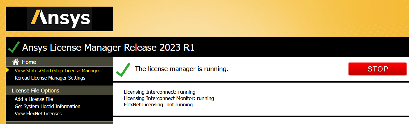

      Hello everyone,
      I have problem with licence to Ansys. In Ansys License Manager I discovered that:
      I'm trying to fix it but I don't know how. Please give me some advice ...
    • VJ
      Hello Dominik, can you open a task manager, go to Details tab and kill the following processes –
      ansysli_monitor.exe
      ansysli_server.exe
      lmgrd.exe (if there are multiple processes, ensure you go to properties and kill the one related to Ansys only).
      Now go to C:\Program Files\Ansys inc\Shared Files\Licensing\license_files dir and delete the ansyslmd.lic file
      Relaunch the Ansys License Manager and install the license file to see if that helps.
