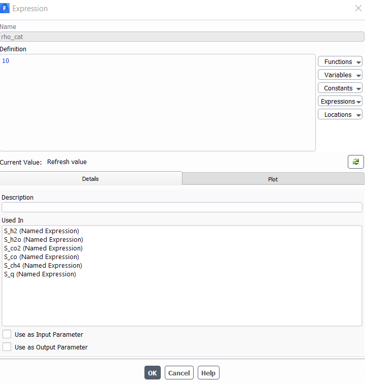

      Recently I am working with the Expression in Fluent. And I have defined a constant in Expression as a Parameter, which I want to change between simulations. And I noticed that, after I change the value of this expression, nothing happens. Only when I restart the Fluent again, the model knows that I have a new Value of that expression? So do I always need to restart fluent again to update the value in the expression?

      Hello Kishan I changed the Value of this expression, which is used in a source term. After changing I direktly click the "calculate" again without touching other settings, and nothing happens. Then I turn off the fluent, restart and click the "calculate", then it works.

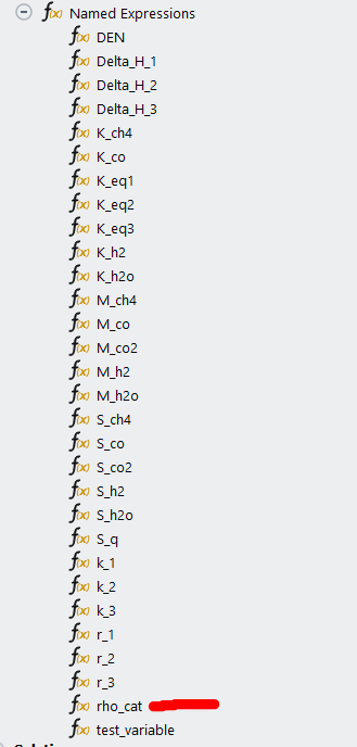

      I defined the following expressions in fluent:
      the one "rho_cat" is a contant without unit:
      as you can see, "rho_cat" are being used in "S_h2", "S_h2o"......
      as a Example "S_h2" are used as a source-term for the species "h2" as in the following picture:
      And My Problem ist, wenn I change the "rho_cat" between two calculations, nothng happens to "S_h2". Only wenn I restart the fluent again, the solver seems to notice that the source term is also changed.

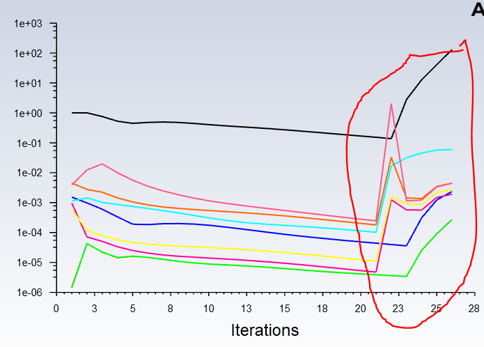

      After 15 Iterations with rho_cat=10:
      Now I change the rho_cat to 15 (It seems nothing happens):
      After I restart the fluent (Now the solver noticed my modification of "rho_cat"):

      Do you monitor S_h2 or a quantity affected by rho_cat? Because the snapshots attached are of residuals.
