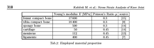

      Material properties being used are that of a healthy person. These are shown in the following table.
      Bones properties

      I attach a CT image of a slice through a knee joint. You can see that the bone is very compact (shows as white) for only a small thickness near the surface and is very spongy (shows as darker) in the center.  The table of bone properties shows that the Young's modulus for compact bone is 17,600 while it is only 500 MPa for spongy bone. If your model of the bone is solid throughout using the compact bone properties, the deformation and therefore the stress will be different in that model compared with a model that has a thin wall of compact bone and a center of spongy bone. You could make some simple geometry and test the effect of a compact bone surface thickness with a spongy interior (or even leave it hollow).

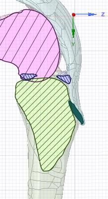

      You can create one bone with two materials, say compact and spongy, by creating a component in Spaceclaim with two bodies using the Fill command on a hollow solid such as Wall 1. I projected a shape onto the wall to apply a force or connect a ligament or a spring to represent the ligament. This is the model I ran the mesh convergence study on, but I suppressed the interior of the bone to reduce the computation time. I have attached the ANSYS 18.2 archive below.

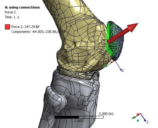

      In the model you sent me, you have Bonded contact between the green faces on the patella and the femur. It's not correct to bond the patella to the femur. This should be a frictional contact since the patella slides on the femur, it is not glued to the femur.
      Your model also has Force 2 on the green faces on the patella. This is not correct. If you had frictional contact between the patella and the femur, the contact reaction force would act in this direction.
      However, to get a frictional contact reaction force in that direction, you have to apply forces to the patella, Fp and Fq as shown in your diagram above. You don't have those forces in your model.
      I recommend you create a spring between the front bottom half of the patella in the direction of Fp, and apply the force Fq to the front top half of the patella. That way ANSYS can slide the patella on the frictional contact to find the static equilibrium of forces acting on the system.
