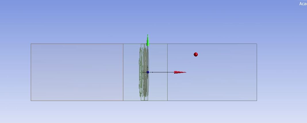

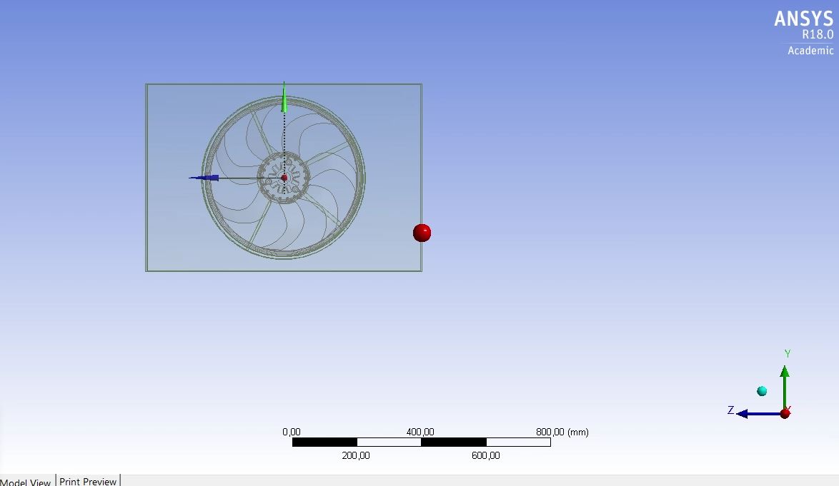

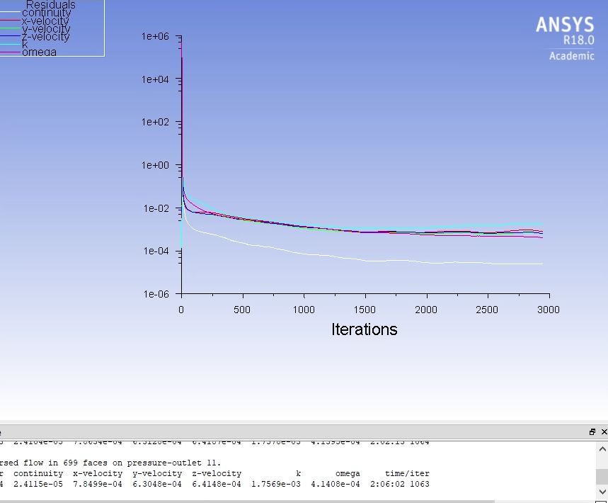

      I am simulating Cooling fan module which is placed in a rectangular pipe, I have a problem with convergence, I ran 5000 iterations but still, the solution isn't convergence, any suggestion to solve this Issue
      Steady state -MRF Method
      K omega SST turbulence model
      boundary conditions- 0 pa inlet and 0pa outlet pressure     mesh : 4.4 million cells

      Can you create a monitor (say avg. velocity at the outlet or avg. velocity at the inlet) and see if you are reaching a steady solution?
      Also, please take a look at your mass flux reports. Is the net value small compared to the mass flux crossing the inlet / outlet boundaries?

      Shouldn't make much difference other than to the solve speed. Put the monitors in as Karthik suggests as I suspect you've got some transients in the flow.
