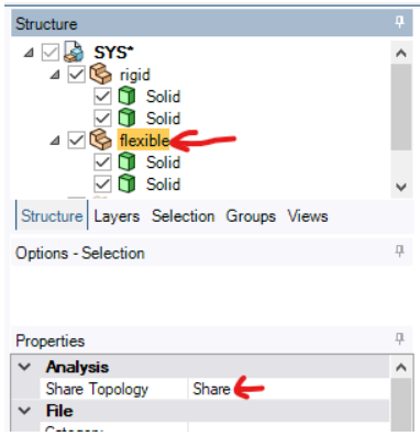

If you want to have same mesh at contacts you can also use share topology in spaceclaim, which ensures the mesh connectivity. Put the bodies under the same component that has itsShared Topologyproperty set to Shared (or Merged in ANSYS 15.0 and 16.0). This property can be found in the properties panel when you select one or more components in theStructure tree.
