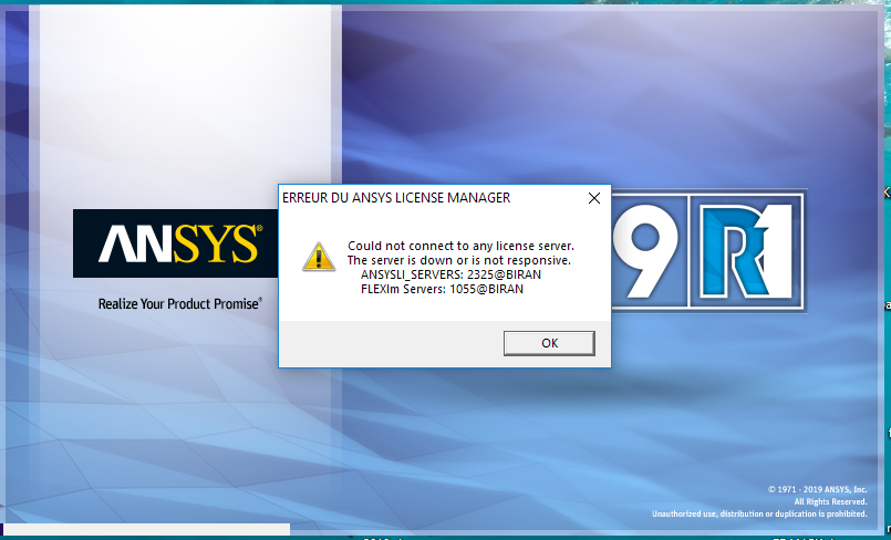

      I have a problem with importing step or scdoc files by double-clicking from Windows.
      I have already performed the operations requested in this ticket:
      Error Opening SCDOC from Windows Explorer
      Now when I launch a scdoc or step by double clicking, I get the error message attach.
      I also have two customers who have the same problem, do you have a solution?
      regards
      Yohann

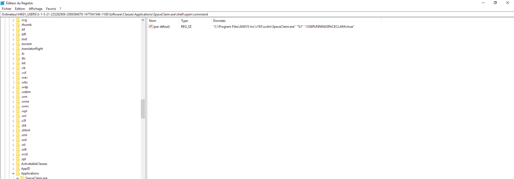

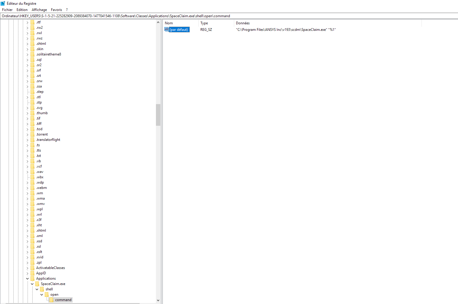

    • Yohann Biran
      Hi Naresh,
      Yes, I see this article, you can see the good folder on my computer bellow. However, what change do I need to make to this registry key ?
    • Naresh Patre
      Hello  NOVACAD
      Can you add  "/USERUNNINGSPACECLAIM=true" to the registry key? The registry key should look like:
      "C:\Program Files\ANSYS Inc\v193\scdm\SpaceClaim.exe" "%1" "/USERUNNINGSPACECLAIM=true"
      Let me know if this helps.
    • Yohann Biran
      Hi Naresh,
      I try to change the registry key as you can see, but the problem is the same ! Other idea ?

    • Yohann Biran
      I Naresh,
      It's okay, when I double-click on a scdoc or step file and spaceclaim is already open, it works fine, the file opens in a new tab.
      However, if spaceclaim is not open, I get the error message below that persists. If you can investigate to improve this in future versions it would be positive.
      Thank you for your help
      Yohann
