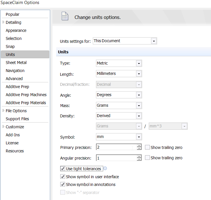

      Hello Robin TEMPORELLI
      Can you please try increasing the precision and also keep the "use tight tolerances" checked ?
