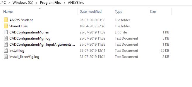

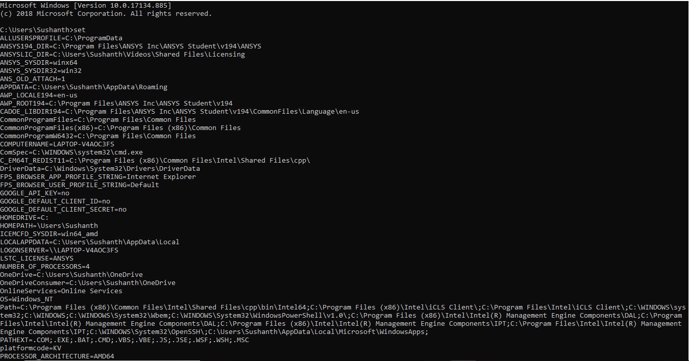

Ansys Employeeopen CMD Prompt, then issue the following command
set
then post the screenshot of it here
Also, post the screenshot of your C:Program FilesANYS Inc folder

Ansys EmployeeIt seems you refer to ANSYS 2019 R2 (19.4) as 19.1
Do you have any .err file in C:Program FilesANSYS IncANSYS Student folder ? If so, please post the entire content of it here.
Try 'unset' (delete) your ANSYSLIC_DIR environment variable.
Also, open CMD Prompt, then issue the following command
move %appdata%ansys %appdata%ansys.bak

Ansys EmployeeYour environment variables and your error message show 19.4 , not 19.1 .
Also, if you look at the folder under C:Program FilesANSYS IncANSYS Student , you are going to see v194 , not v191.
