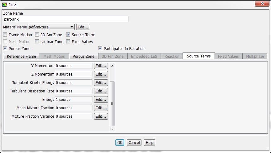

      problem 2.
      when i try to calculate using non premixed - PDF approach as shown below
      the option for entering the species in my case CO gas vanishes i.e. i cant enter any gas species source terms but energy species can be entered as usual. i have given the pic below?
      Kindly reply sir.............. are there any sort of reviews for my problems ?
    • Amine Ben Hadj Ali
      For problem 1 do you need the UDF to enter the CO mass? Mass source as usual via cell zones.
      For problem 2 that is clear as the mass reactions are backed from lookup tables (that is why I wrote not share things related to PdF)
