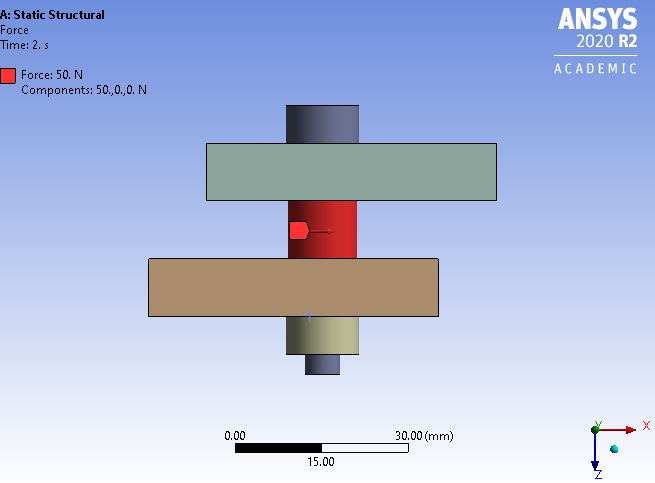

    • Ashish151215
      In this model I wanted to check the shear load on the spacer.
      Kindly check if model is correct or not? Also I want to see fatigue life of bolt in Zero based loading. Consider the force (50N) being applied constantly by a cylinder on the spacer. The FOS of bolt comes out to be 0.19.
      Even if i don't apply a load, the pretension only gives a stress of somewhere around 500 Mpa. Are these results practical? The Max. stress is 86.7 Mpa for infinite bolt life. Can you please make me understand how can one achieve full design life of a bolt in ansys?

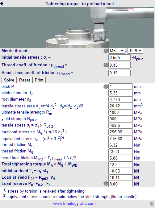

      The bolt seems to be an M6 bolt since I measured it as having a 6 mm shaft diameter.
      I recommend you use a Bolt Preload Calculator such as this one: https://www.tribology-abc.com/calculators/e3_6a.htm
      Bolts come in a variety of material strengths. In the image above, I have selected a Grade 10.9 material which has a yield strength of 900 MPa.
      You have assigned Structural Steel with a yield strength of 250 MPa to the bolt. Change the material yield strength of the bolt to a higher value and the bolt equivalent stress will be less than the new higher yield strength.

      Is the 50 N load in the X direction a cyclic load? Does it change from 0 to 50 N to build up cycles over its life?
      The bolt experiences almost zero change in stress due to the application of this 50 N load. Look at the bolt stress between the end of step 1 and the end of step 2. It goes from 553.25 MPa to 553.43 MPa. That is the alternating stress you should be using in the Fatigue calculation on the bolt.
