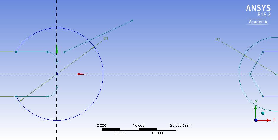

Ansys EmployeeIt could be only graphical representation.Â
Please go ahead and create 3D bodies from this sketch and check if it gives any problem.Â
November 22, 2018 at 4:10 am
Keyur Kanade
Ansys EmployeeIf you go to Tools - Options - DM - Graphics - Facet Quality and change this to 10, you will see improvement in display.Â
So its only display issue. You can go ahead with your model.Â
