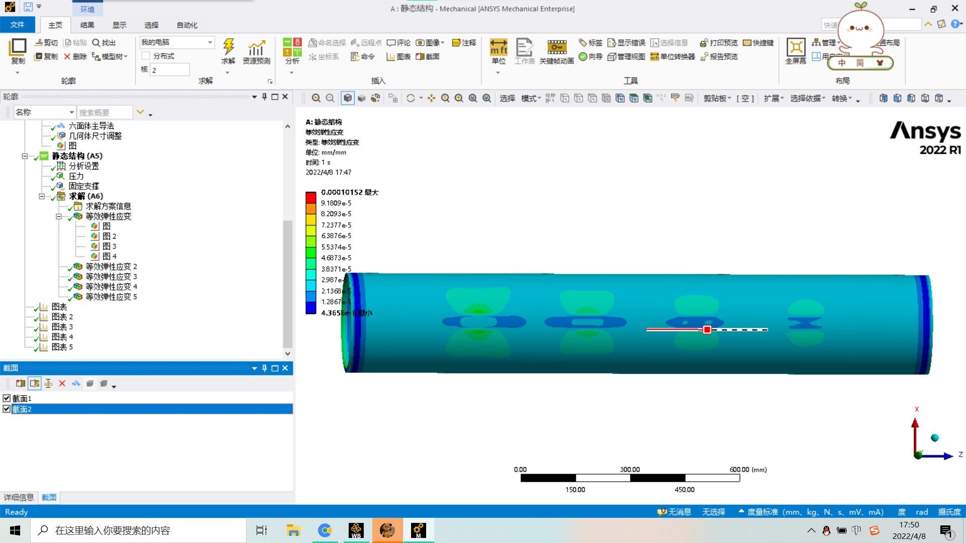

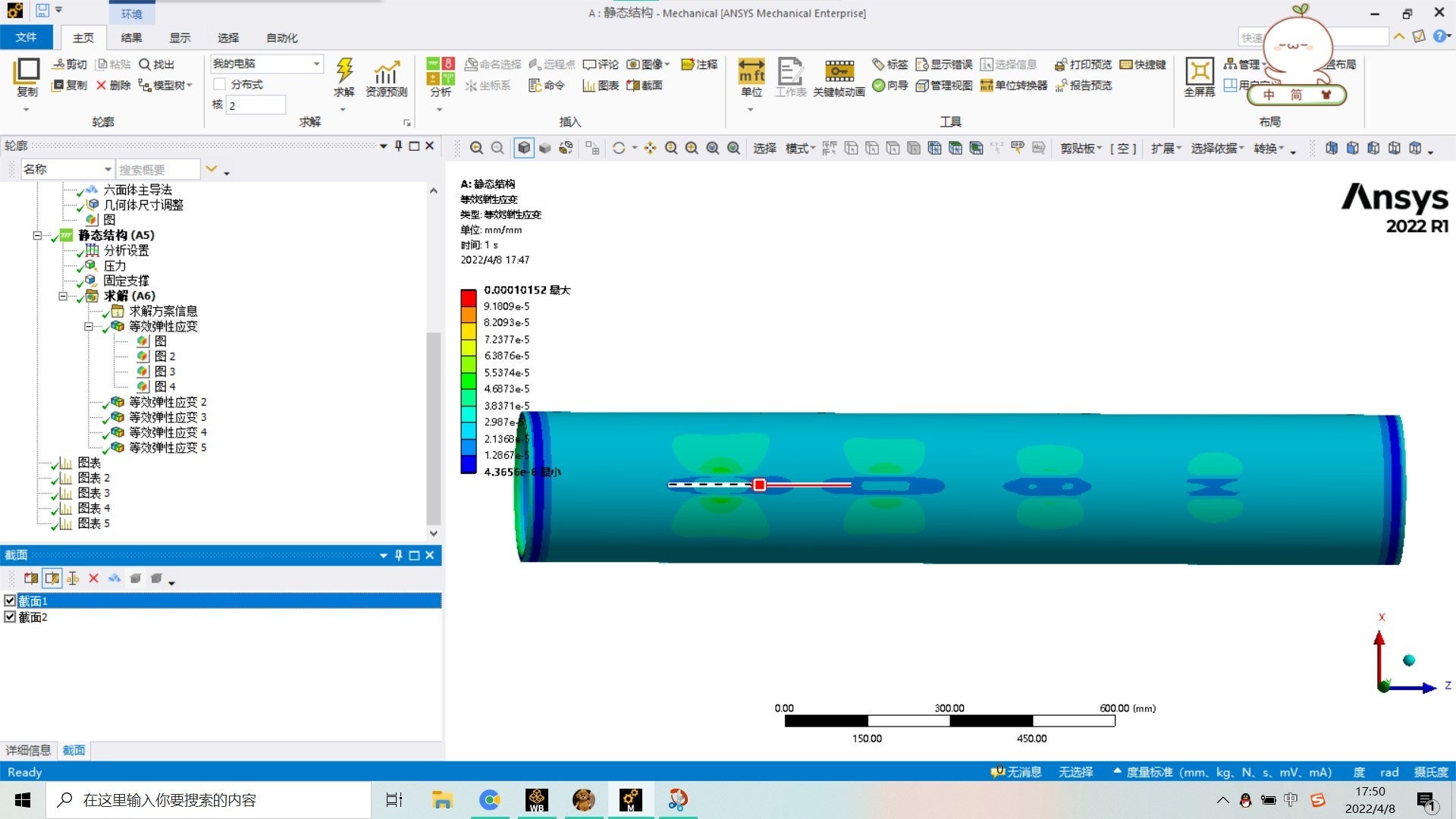

       I want to divide a pipe into 3 sections with 2 section planes,and only display the middle section. But it always displays two sections of them. What should I do to solve it?

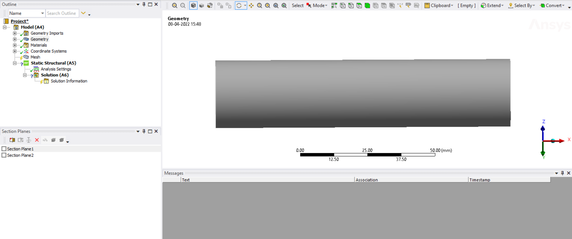

      Thank you for your patience. I've tried your opration before but it did not work.As following pics show, I set the section planes correctly but it displays the whole pipe.
      thanks again.(Ps:I don't know how to @ somebody)

      by the way, Can you see the 2nd picture?@ Amaniyar

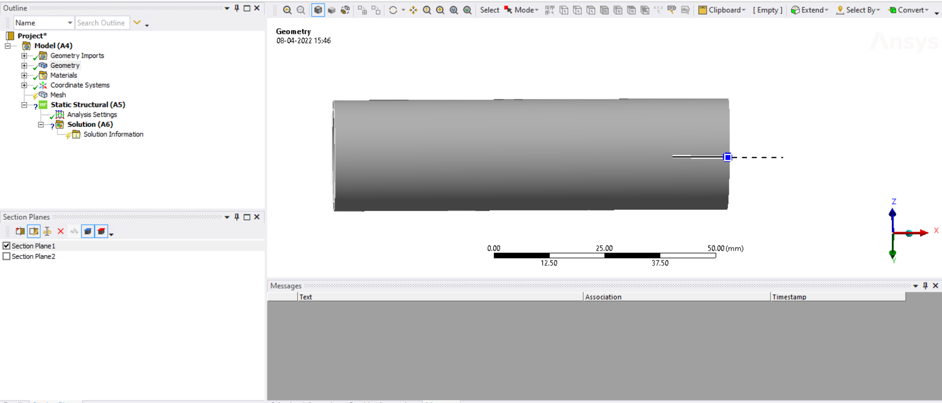

    • Akshay Maniyar
      Yes, I am able to see both the picture.
      Also, I have tried the same way, and it works for me. Please check the full geometry of pipe.
      Now, I will turn ON the section plane 1.
      I will turn ON section plane 2.
      It shows the middle portion properly.

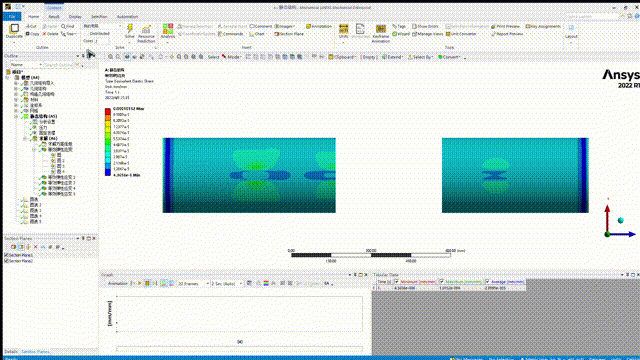

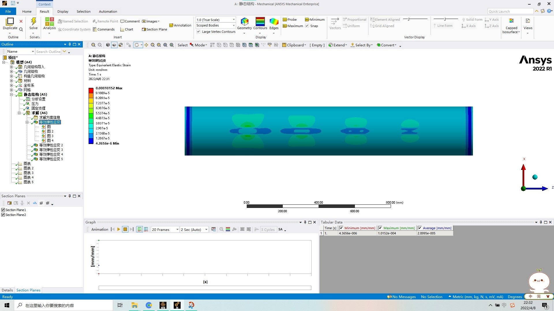

      Hello, I found a strange phenomenon just now. When I click the "solution", it did display the middle portion, but when I cilcked one of strain contours, it showed the whole pipe again´╝ü
      Now I inferring that the two parts on each section plane's visable side are simply overlapped, but not performed ÔÇÿ&ÔÇÖ´╝êAND´╝ë operation.
      Do you know how to fix it?
      Thanks Zhang
    • Akshay Maniyar
      Section planes behave differently for geometry and results. Please check the Ansys help link for more details.When viewing a result or a mesh, the cut is performed by a software algorithm. When viewing geometry, the cut is performed using a hardware clipping method. This hardware clipping cuts away the model in a subtractive method. The software algorithm cuts away the model but always starts with the whole model. Because of this, it is not taking effect of 2 section plane while viewing results.
      The workaround which I can think of is to cut the pipe in 3 parts in SpaceClaim and use share topology. So that, you can extract results for middle portion as a separate part.
