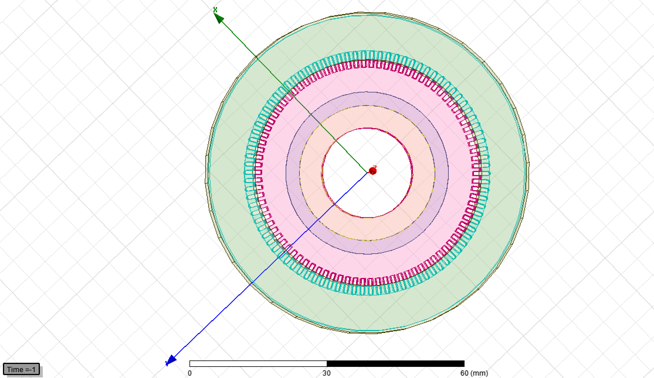

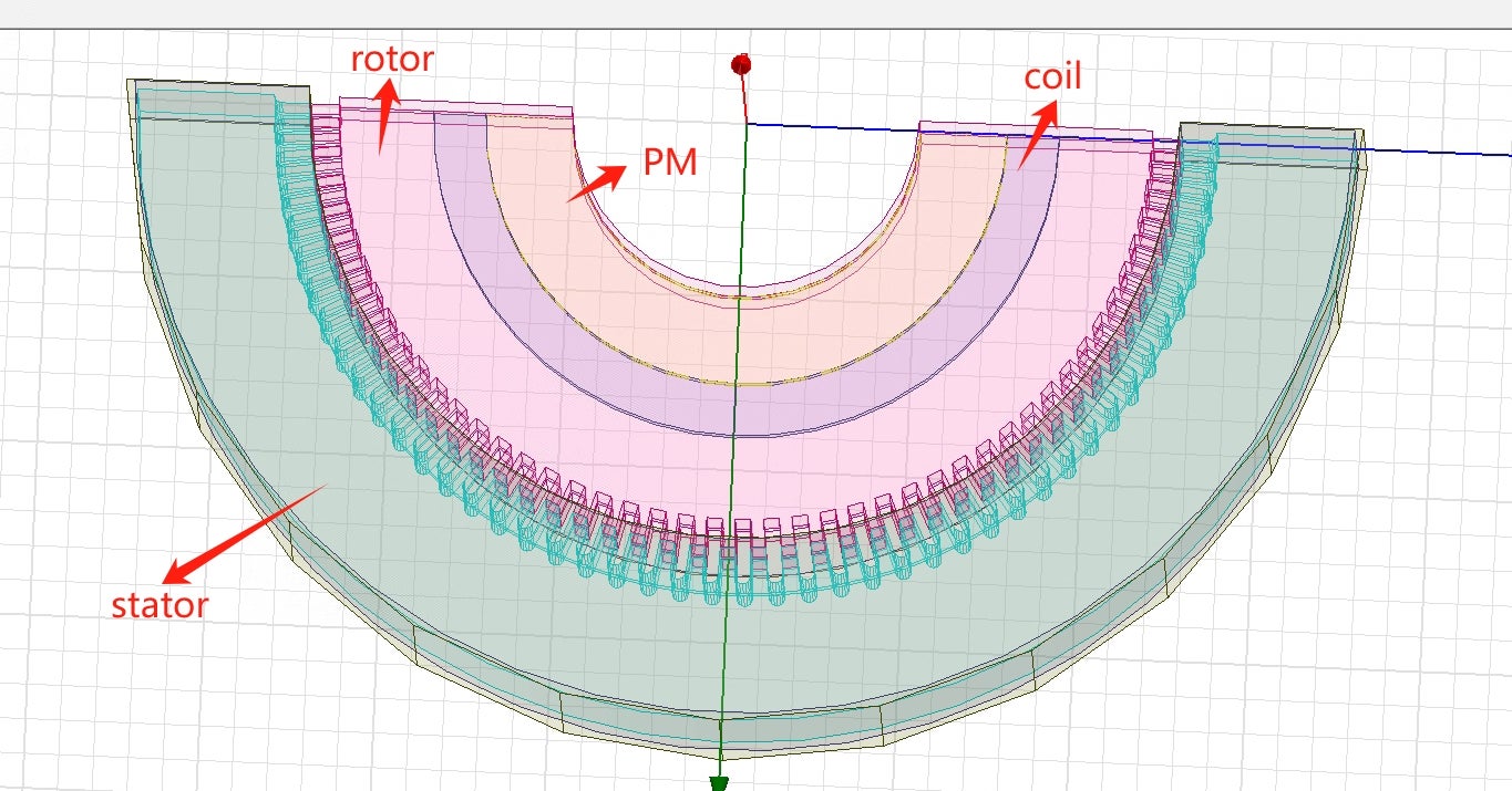

      When I'm running analysis of my model, the problem "4023 of band mesh nodes are shared by both moving and static objects" occurs.How can I solve this kind of problem? The structure of my model is shown below (sorry that I mark "stator" and "rotor" opposite, the pink one should be the stator.) ).

      Hi Juefei, All moving objects must be included in band object, could you show the band object? If the rotor and stator are marked opposite, is the PM on the stator (pink object)?
      • Juefei Li
        Yes, PM is on the stator. And the band is like this~ Thanks for helping~

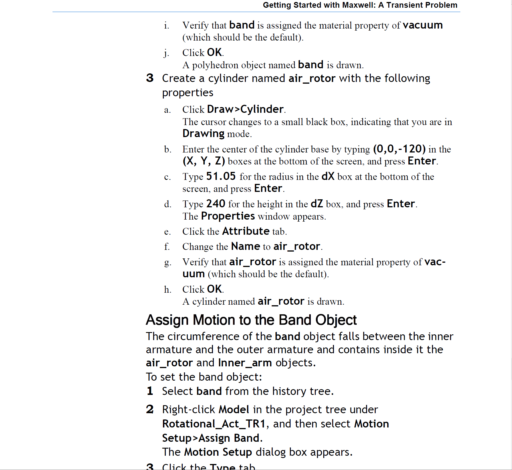

          3. If there is more than one moving parts, or the one moving parts has holes on it. It is strongly recommended to add an inner band object to enclosing all moving parts. Innver band must be smaller than band, and fully enclosed by the band without overlapping with it. There should be enough room between the container and the band to allow motion. During the movement, the inner band will not touch the band.
        • Juefei Li
          Thanks for your tips. I've made sure of tip no.1 and 2 (though I wonder what a true surface is... not really sure of the definition...). About tip no.3, I've drawn an "air-rotor" following the instructions in the "getting started guide". Is it equal to inner band?
