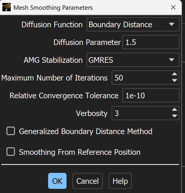

      • Diffusion smoothing, with AMG Stabizilation set as GMRES. ( with Verboisty 3, to help debug)

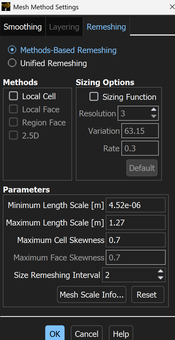

      • Remeshing (Methods-Based Remeshing, 2 interval) with parameters set from initial mesh stats - Also tried turning this off, and preview still works.

      Can you show some screenshots of your model/mesh and Dynamic Mesh settings?
    • fakhreddine.madi

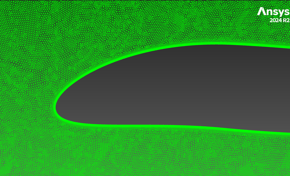

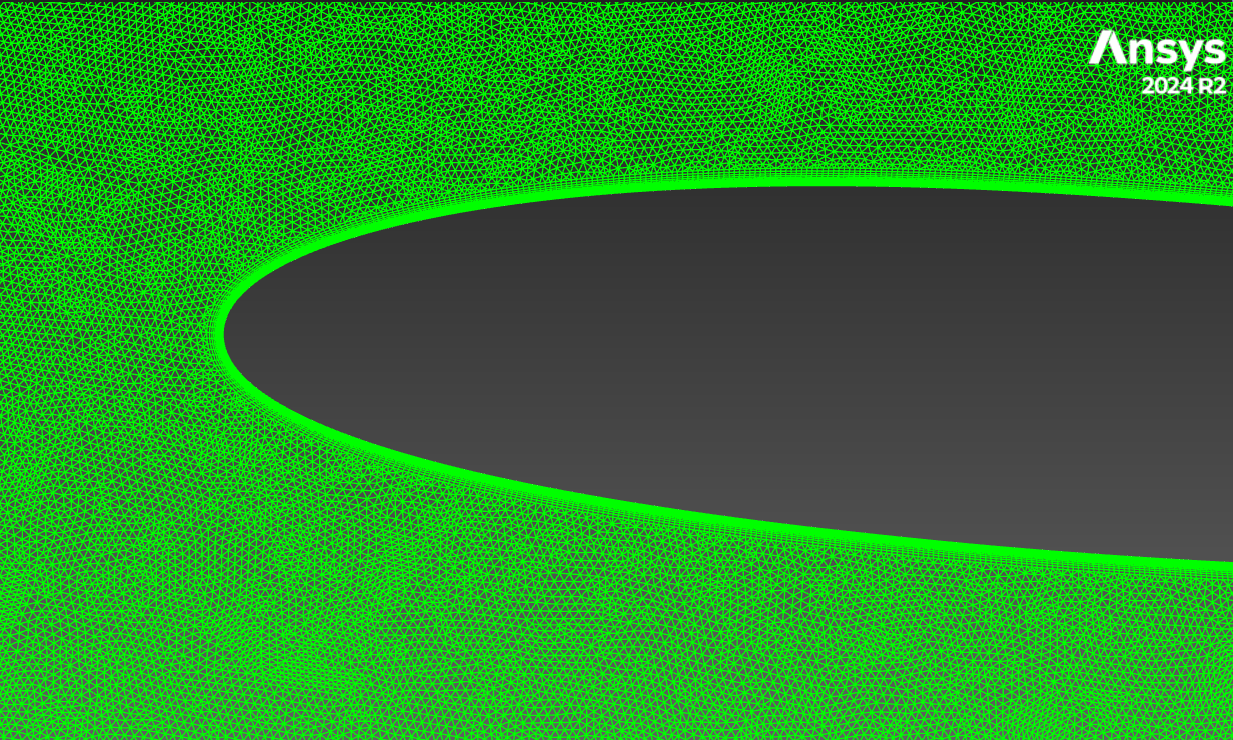

      Here are a few snips of my setting, I also added a snip of the model with mesh at max deflection. I don't always use remesh, but those are the settings I have used before.

      Sorry, I forgot to mention that I also have “Local cell” clicked on, which I forgot to apply to the snip. (But I also have tried not using that option, but it does not impact the issue I am facing, as it helps with remeshing tets, but still end up getting the same error as before, regardless.)
