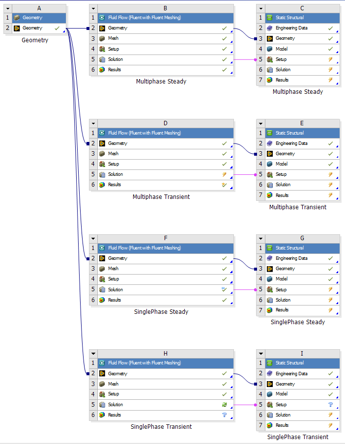

SubscriberWhen I transfer results from fluent to static structural I get and error if I have applied multiphase.
I have done the same simulation, with static (singlephase), transient (singlephase), transient (multiphase) and the first two pressures were well exported to static structural, but when I use multiphase, It says that no pressures are found on the face selection

Ansys EmployeeHow are you transferring? Can you add a screenshot?

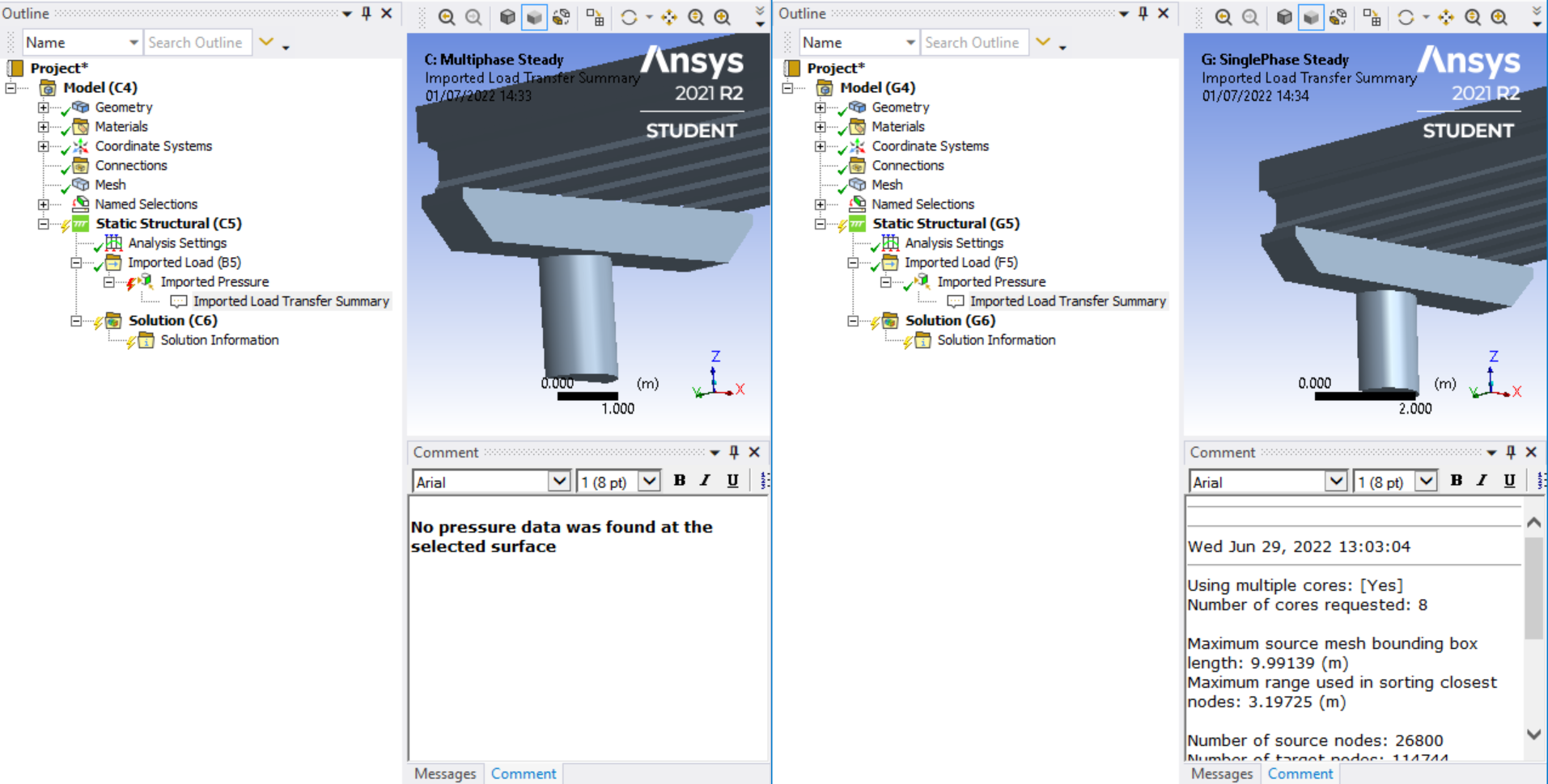

SubscriberI have first created the workflow for Multiphase and then copied it, and modified it for doing a Single phase.
I have also included the Static Structural screenshot in which for the Multiphase it says "No pressure data was found on the selected surfaces".
I think the workflow works, since the SinglePhase is just a copy of the Multiphase, I have just changed the VOF.

July 4, 2022 at 2:50 pm
Rob
Forum ModeratorIf you open up the Fluent solver have you got pressure data in the model? Ie has it run?Â
July 5, 2022 at 7:30 am
pv00170
SubscriberYes! Both Fluent models got pressure results.
The only thing is that Static Structural doesn't read the results when using Multiphase.
I don't know if its a problem I just encounter.

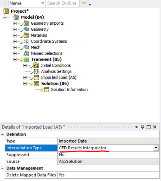

October 11, 2022 at 5:56 pm
Rahul
Ansys EmployeeHi,
Please try with changing the 'interpolation type' from 'Mechanical based Mapping' to 'CFD results interpolator'.ÂMechanical-Based Mapping only imports normal pressure.
Please refer Using Imported Loads for One-Way FSI (ansys.com) for more information.
Hope this helps you!
October 17, 2022 at 11:21 am
pv00170
SubscriberIt says:
CFD Load Transfer Summary
-- ERROR -- Cannot calculate force. Variable 'Mixture.Volume Fraction' does not exist.
October 17, 2022 at 11:59 am
Rahul
Ansys EmployeeÂ
It may happen due to fluent results files saved in HDF5 (.dat.h5) format and we are looking into it. As a workaround, please change the default file saving option to legacy format (.dat/.dat.gz) and then try to import load.Â
