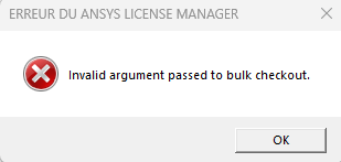

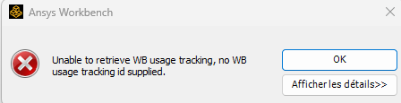

I have downloaded the Ansys 2023 R2 Academic version.Â
When I start Workbench I get the following error message :Â
And when I try to start DesignModeler I get this error and I cannot use any of the fonctionnalities :
Do you know how to solve this issue ?Â
Thanks in advance, have a ncie day.Â

Ansys EmployeeCheck your firewall settings.
As a test, try disabling it and start WBIf that does not help, I would recommend to uninstall.Â
Rename %APPDATA%\Ansys\v232 to v232.old
Rename c:\Ansys Inc to Ansys_old
Reinstall by right-clicking on setup.exe from download and choosing ->more->run as administratorÂ
