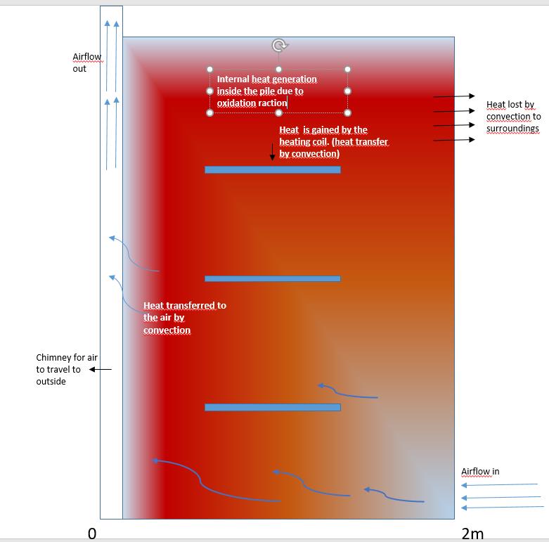

      I have the problem of a reactor that has heat exchanging pipes through it. Biomass is placed in the reactor and with the flow of air combustion starts and air exits through the chimney transfering heat to the heat exchange pipes.
      My question is, is there a possibility to simulate biomass combustion and associated chemical reaction in ANSYS. What are some good method to understand the way this simulation has to be done.

      The boiler has heat exchangers and the heat carried away by heat exchangers must be studied. The biomass in the boiler burns out and thus a simulation model has to be made. As I understand the the following are the steps to be followed.
      A 3D or 2D model has to be made in design modeler, The heat exchanger or the heat sink carry some heat outside, while the combustion products rexit through the outlet pipe.
      Since biomass combustion happens and the chemical reactions are known how is it possible to simulate the chemical reaction and correspoding heat increase and heat carried away by the heat exchanger.
      How is it possible to develop a mathematical formulation for this and based on this what must be the approach to develop a model.

       First consider the heat generation take place by giving the heat flux value and applying it to the whole surface as shown in the tutorial and simultaneously modeling the heat extracted by the heat sink?
      Source to add the heat. Sink to remove, or conduction/convection. It's not clear how air gets from the combustion zone into the chimney so you'll need to explain in more details.
