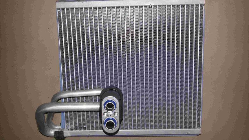

porous medium heat exchange
    • neo
      If I know the temperature or heat exchange power of the heat exchanger
      How to set the porous medium heat exchange in discoverylive

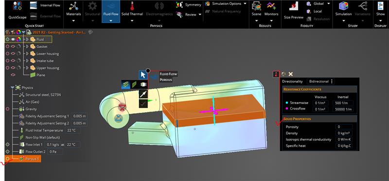

        I already know how to set  porous media ,But I don't know how to set up heat exchange with porous media model in discoverylive ,If the temperature of porous media is 80 °, how to set it?
        thank you
      • Devendra Badgujar
        Hello neo
        No, we can not apply boundary conditions to interior region (as porous inlet and outlet are fluid interior regions and not walls).
        You should be able to specify temperature on side walls of porous region though (as long as this is wall and not interface)
        Also you can include these thermal effects in Porous medium shown in the attached image.
