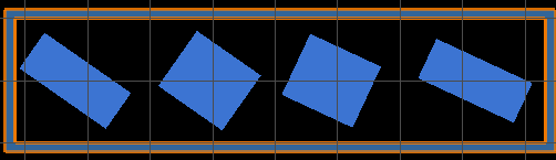

SubscriberHere is the details of my metasurface. its periodic in x and y as shown below.

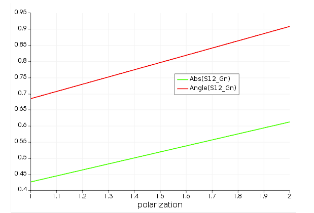

Subscriberand yes, i used https://support.lumerical.com/hc/en-us/articles/360042095873-Metamaterial-S-parameter-extraction for tha same purpose but i could get the same polarisation when go back. It shold be simple but somehow it is not giving the exact result. Here is the detail.
(1) So i used p light incidnet on Metasurface and using s polarisation in s-parameter i got this information about the E field.
(2) Now using this data in my source of S and P light with proper phase difference and amplitude , i was unable to get back to initial result again.

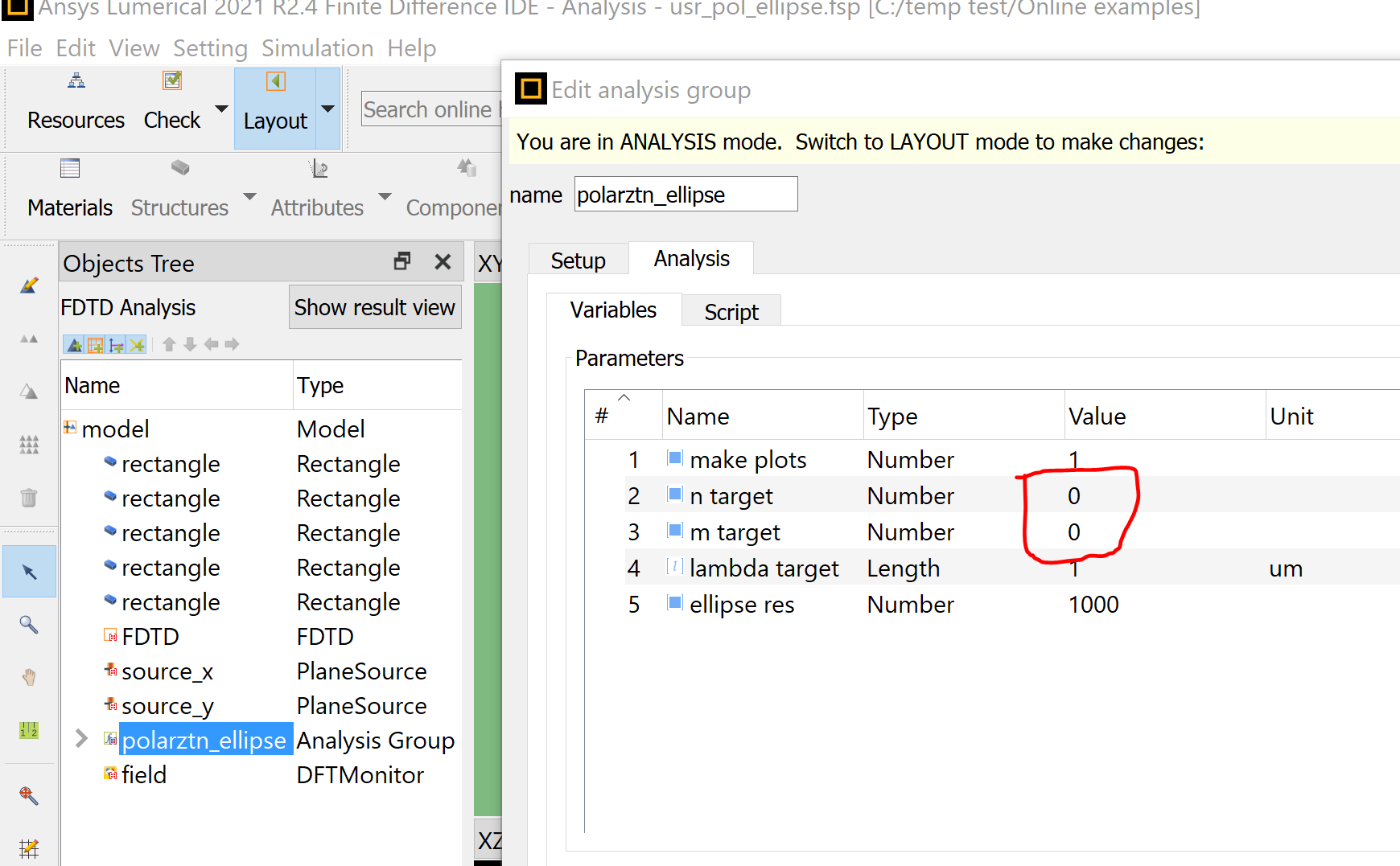

Ansys EmployeeCould you please define "polarisation state"? if it is the ellipse parameters, you can specify the diffraction order first:
Then you will get the result for the specified order. For other orders, simply repeat this procedure without re-doing the simulation.

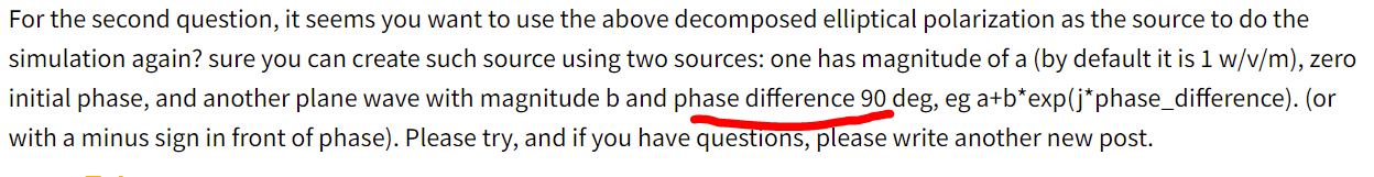

For the second question, it seems you want to use the above decomposed elliptical polarization as the source to do the simulation again? sure you can create such source using two sources: one has magnitude of a (by default it is 1 w/v/m), zero initial phase, and another plane wave with magnitude b and phase difference 90 deg, eg a+b*exp(j*phase_difference). (or with a minus sign in front of phase). Please try, and if you have questions, please write another new post.
