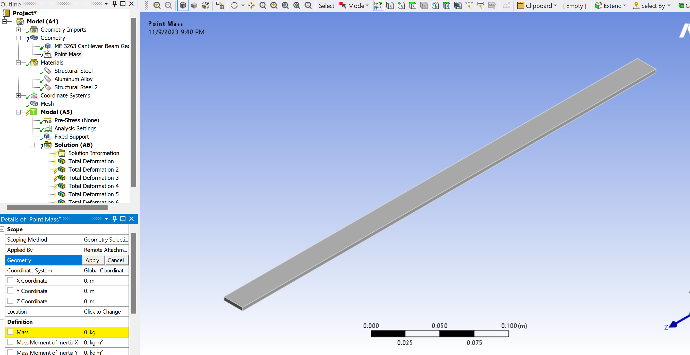

You can split the beam faces (say top face) as needed in Spaceclaim, and then scope the point mass to a specific location/area.
Added sitting (not sure what it means), but I will assume it is something adding mass (not stiffness) to the the structure, then it can be represented as a point mass scope as we said to a face.
