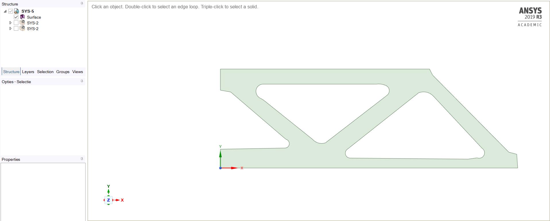

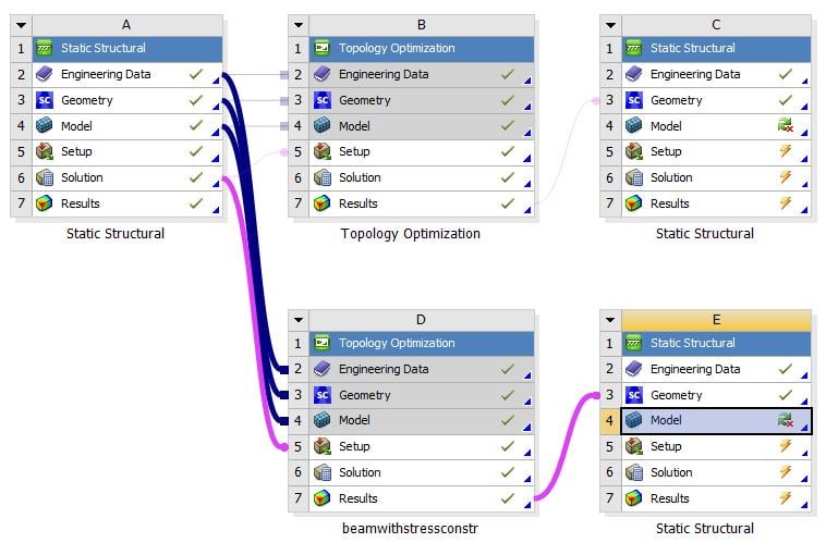

I am analysing a 2D geometry. it is a 2D beam and I topologically optimized it. After, I transferred the results to a design validation system. I adjusted the geometry and the tiny errors and got a nice truss to evaluate. when I try to import it in my model, it gives following errors and warnings:Â
-warning: surface body 'surface' was invalid for a 2D analysis and not transferred. Ensure that the body lies completely on the XY plane and its bounding box does not have a Z-component
-plugin Error: failed to import assembly from SpaceClaim. no bodies to transfer.
-plugin error: refresh failed.
-warning: one or more objects may have lost some scoping attachments during the geometry update. you can identify these tree objects by filtering the tree using the scoping option set to partial.
I read other threads and I am sure my drawing (name 'surface'), lays in the XY plane and also that it is a surface and not just curves. Anyone any suggestions?
In attachments my workbench and Spaceclaim layout.
