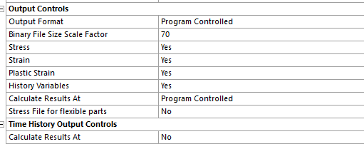

How can I have a more data Points in my results so that I can plot smoother curves?
I have tried different Things but number of data Points remain fixed at 21.
October 27, 2020 at 12:02 pmpeteroznewman
SubscriberUnder Analysis Settings is the Output Controls category. Expand that and you will see Result Number of Points with a default value of 20. Type in 200 or 1000.nOctober 27, 2020 at 12:50 pmOctober 27, 2020 at 1:55 pmChris Quan
Ansys EmployeeChange Program Controlled in Calculate Results At to increase the number of results saved. nOctober 27, 2020 at 2:16 pmWasif
Subscriberyes it solves the problem. Thanks!nViewing 4 reply threads- The topic ‘plotting more data points for smoother plots’ is closed to new replies.
