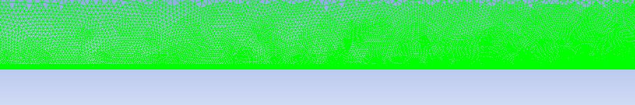

Forum ModeratorHow much mesh have you got in the near wall region?Â

Ansys Employee1/Use Low-Reynolds mesh with yplus 1 to 5 and at least 15 cells in boundary layers
2/Make a grid sensitivity analysis and work with high order schemes
3/Comapre with other RANS turbulence models (SST, Realizable with EWT or Menter Lechner) and especially the one which might account for anisotropy: RSM
3/Are you plotting the value directly after the expansion region / step (weak recirculation zone)
4/Judge your results describe them and document them
there is no bad correct or wrong results: only bad or good comments on results.Â

Ansys EmployeeJust make rough estimation for yplus and use conservative cell growth rate for the first cells near the walls. Run once. Have a look into the turbulent viscosity ratio. The Max should of will indicate approximately the middle if boundary layer. If the resolution not enough remesh and rerun...
