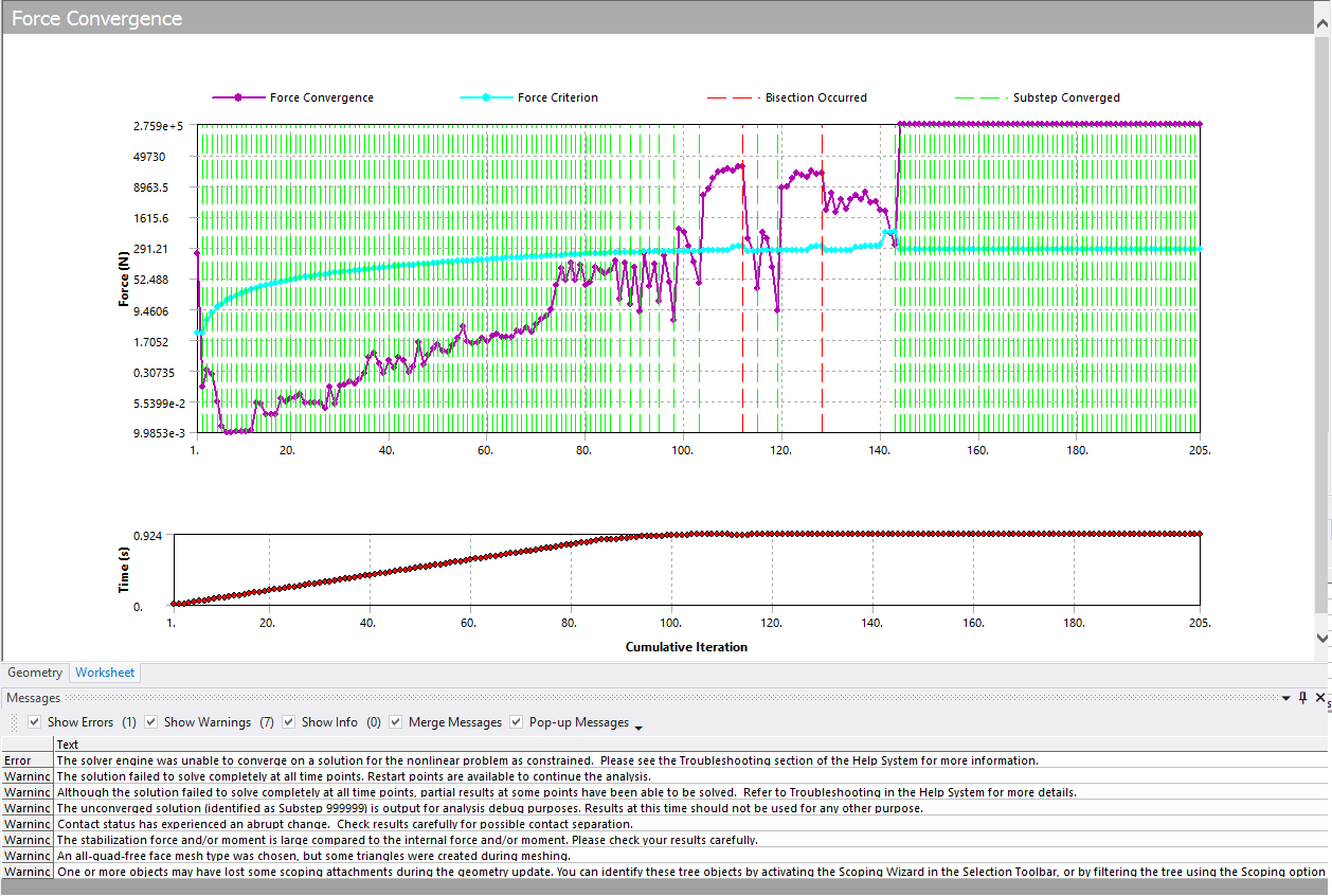

      This is what the force convergance chart looks like
      I was getting results like this but it was failing so I added in the SEMIIMPLICIT commandline in the APDL.
      This is the error I get:
         >>> SOLUTION CONVERGED AFTER EQUILIBRIUM ITERATION  15
       *** WARNING ***                         CP =    3420.078   TIME= 13:12:27
       For load step 1 substep 94, stabilization moment norm = 31.5757016 is
       large compared to the internal moment norm 47.3393818.  Please check
       the result carefully.
       *** LOAD STEP     1   SUBSTEP    94  COMPLETED.    CUM ITER =    143
       *** TIME =  0.922000         TIME INC =  0.400000E-02
       *** MAX PLASTIC STRAIN STEP = 0.1816       CRITERION = 0.1500
       *** AUTO STEP TIME:  NEXT TIME INC = 0.40000E-02  UNCHANGED
           FORCE CONVERGENCE VALUE  =  0.2759E+06  CRITERION=   266.2
           MOMENT CONVERGENCE VALUE =   1297.      CRITERION=  0.2306
           DISP CONVERGENCE VALUE   =  0.1616E-01  CRITERION=  0.1629E-02
          EQUIL ITER   1 COMPLETED.  NEW TRIANG MATRIX.  MAX DOF INC=  -4.487
       *** ERROR ***                           CP =    3430.438   TIME= 13:12:38
       Element 104714 has excessive distortion.
       *** WARNING ***                         CP =    3430.453   TIME= 13:12:38
       Contact status (Real ID: 4) changes abruptly from in-contact to
       far-field.
          >>> TRANSITIONING TO SEMI-IMPLICIT METHOD

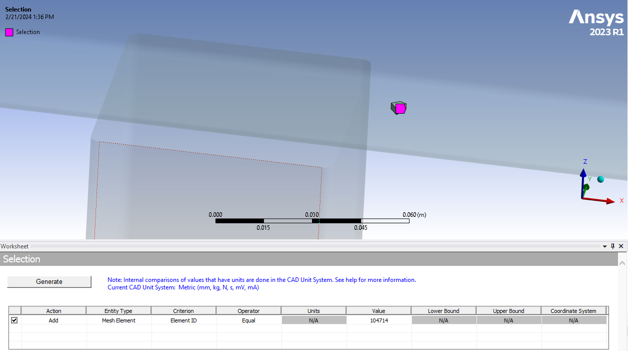

      This is element 104714

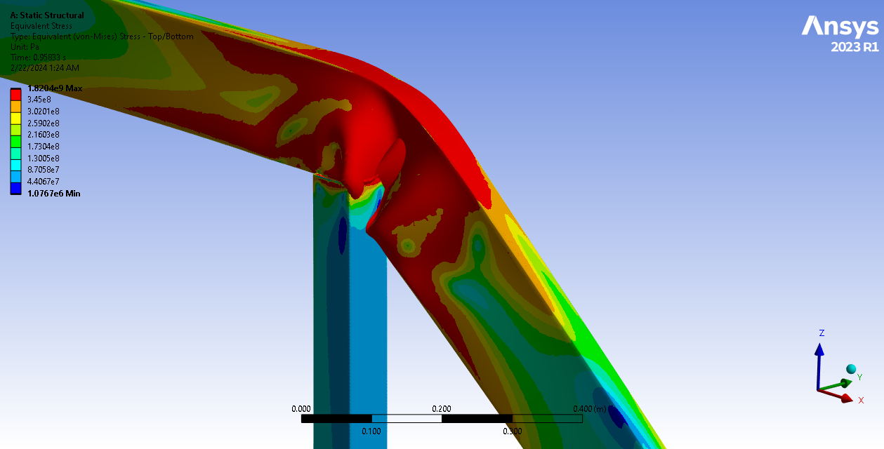

      Now this all makes sense but I the question is, is there a way to allow the analysis to go further?  I would like to see more buckling and then see the spring-back in a second step where the force is removed.  So far the analysis fails before reaching step 2.  I tried reducing the loading until it converges (about 55,000n) and I got the analysis to successfully move to step 2 but there is no buckling (Step 2 did fail but I think it's because I had it set to auto time stepping).
      I have the time stepping set to 100 initial steps with 250 max.  I did this because I didn't want the analysis going forever.  It looks like it's failing because of excessive deformation anyway, not because I don't have enough time steps but I'm very open to opinions.

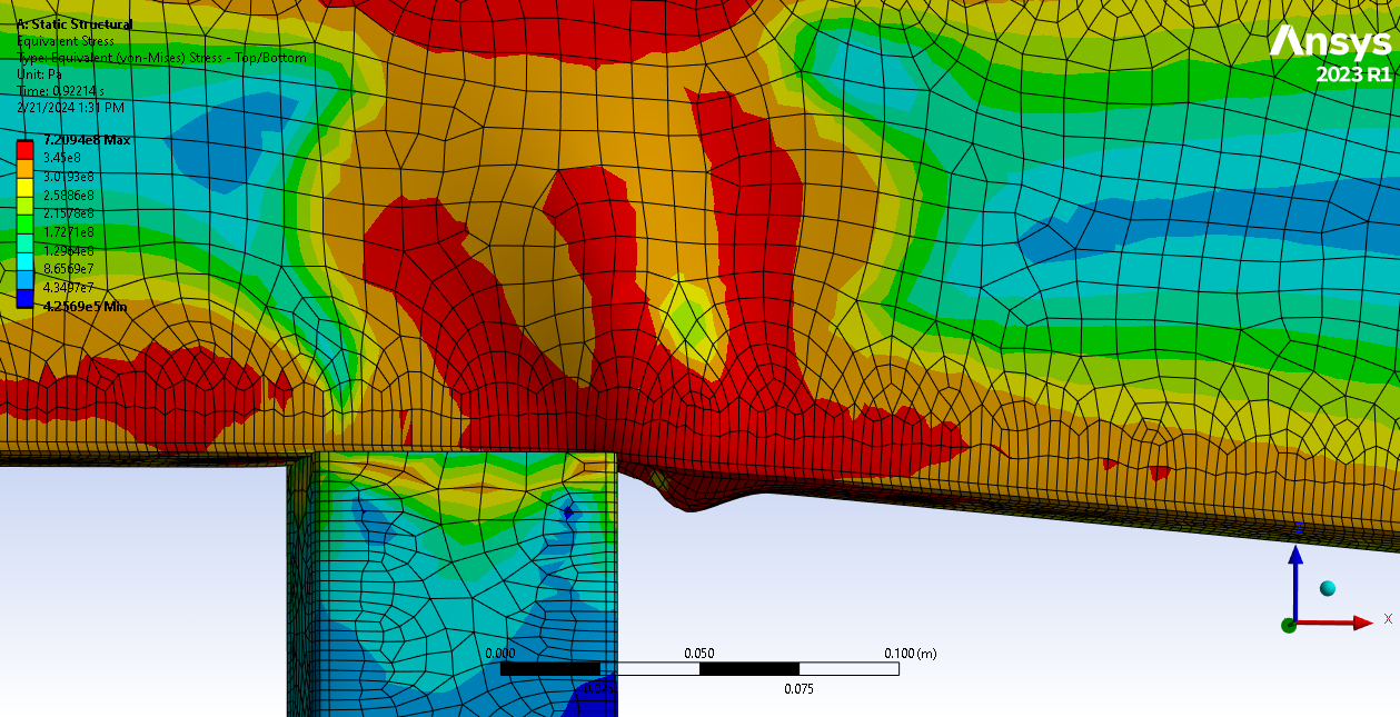

        I remeshed the whole thing with a 2.5mm triangular mesh and got some really good results but the bodies pass through one another with large deformation.  Is there a way to prevent the meshes from passing through one another?  I tried a frictionless contact between the surfaces with the largest deformation but my analysis stalled out.   This is the best I've been able to do so far:

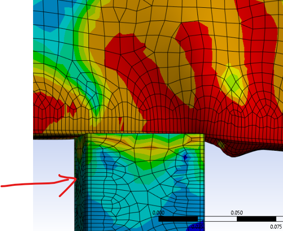

    • wallybanger
      I don't think I understand what you mean.  So there is a post and a truss.  The post is the vertical part.  The truss is the horizontal part that is deflecting.
      I can set up a contact between the bottom face of the truss and the forward face of the post where they would make contact with one another.  Is that what you mean?   I tried that.  The analysis failed and didn't even give me results I could view.  The bottom face of the truss is already being used in a bonded contact with the top of the post.  Could that be causing the problem?  Do I need to define a seperate face to use for the contact?
      I was thinking that maybe it would be better to mesh the entire thing as a solid part as opposed to 2 parts but if you look at the truss you can see that the inside and outside faces are crossing through one another so ansys doesn't even know when a body mesh is self intersecting... which is insane.
      How can I stop those meshes from passing through one another?

      OK, I looked at the solver output and it definitely says it's failing because of too much penetration.
      I understand completely how there can be penetration between 2 seperate bodies with no connections between them but how is a single part/mesh allowed to penetrate it's self?  Is this because the solver switches to semi implicit??  Is there a setting I'm missing or something I need to change in the solver settings?
