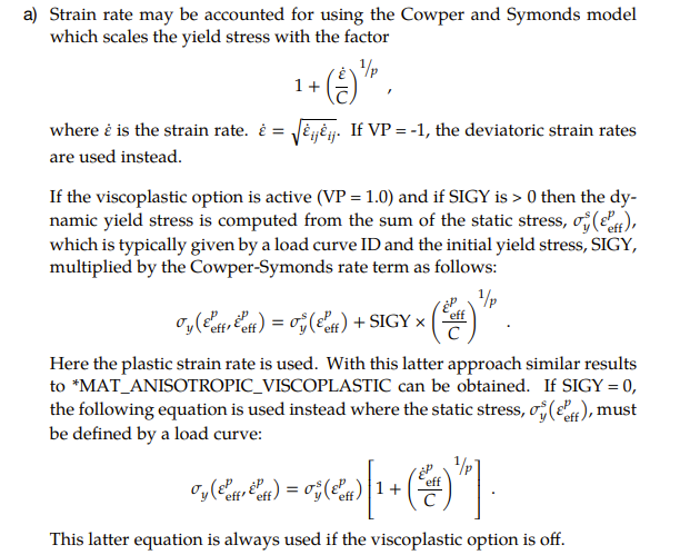

      In MAT_24, C and P are coefficients in the Cowper-Symonds model, which accounts for strain rate sensitivity. These coefficients depend on the material being analyzed. As described below, the Cowper-Symonds term is multiplied by the yield stress to calculate the dynamic yield stress (see the screenshot below from the keyword manual).
