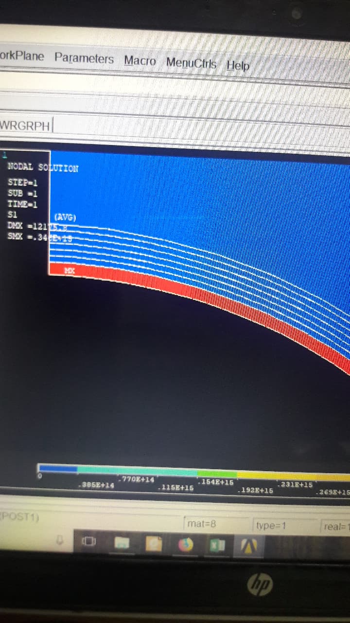

      when i create layered cylinder with different material then putting pressure on the inner line of the cylinder i get the max stress only for the first layer.Adjaent layer next to the first layer has no radial stress.I am very upset with this.Anyone can help me regarding this problem?I badly need assistance.
      Thanks in advance.Here i attached the nodal solution of stress where i can see that only frst layer got pressure and felt stressed.But the other layer is blue totally

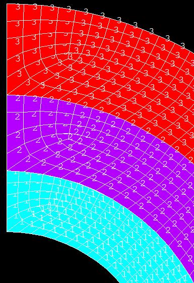

      I don't use APDL classic ANSYS, but I was able to open and solve your file.
      One observation is that the nodes between the inner and the middle rings don't line up,
      while the nodes between the middle and outer rings do line up.
      Is there contact between the inner and middle ring, or is this the mistake you are looking for?
      If someone else can help, that would be great.
      You must either:
      1) Add bonded contact between each layer or
      2) Line up the nodes at the two interfaces between the rings and merge coincident nodes.
      I know how to do that in Mechanical and I don't know how to do that in ANSYS APDL.
