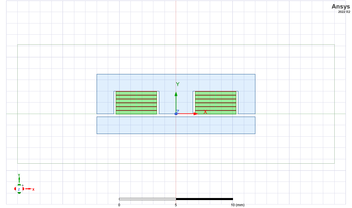

      I am trying to analyze a multi-layer planar inductor in Maxwell 2D and I am having trouble calculating the AC resistance and Inductance of the model as a function of frequency.
      The model is as follows:
      Here, the red rectangles indicate copper trace and the green rectangles indicate dielectric material in the PCB stack-up.

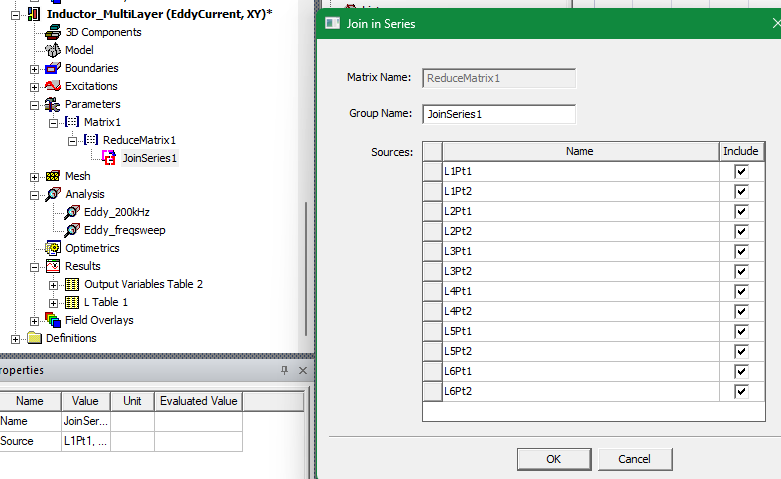

      The matrix is defined as follows:
      All the copper traces are connected in series.

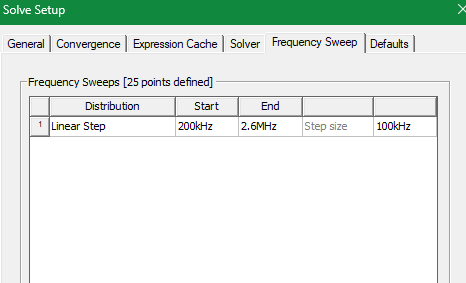

      I have set up a frequency sweep in the analysis set-up as follows:

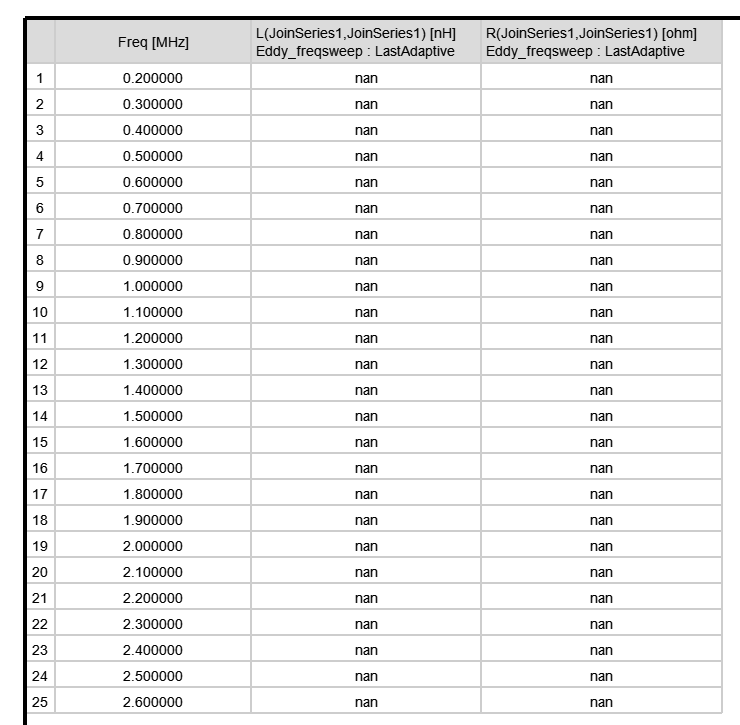

      The simulation results are as follows:
      For the main matrix:
      I'm not sure where I am going wrong in this simulation. I'd appreciate any help regarding the same.

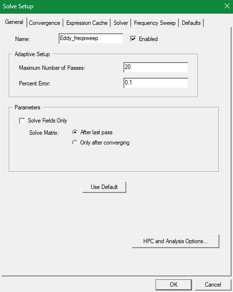

    • GLUO
      Please uncheck "Solve Fields Only" in the Solve Setup>>General.
      GL
      • shsi3480
        Thank you for your prompt response. I do not have solve fields only checked in the solve setup. This is how my set-up looks like:
        • GLUO
          It is hard to tell what went wrong here. Please use the support button on the left of this page and submit a service ticket to have our engineer look at your cases in detail.
