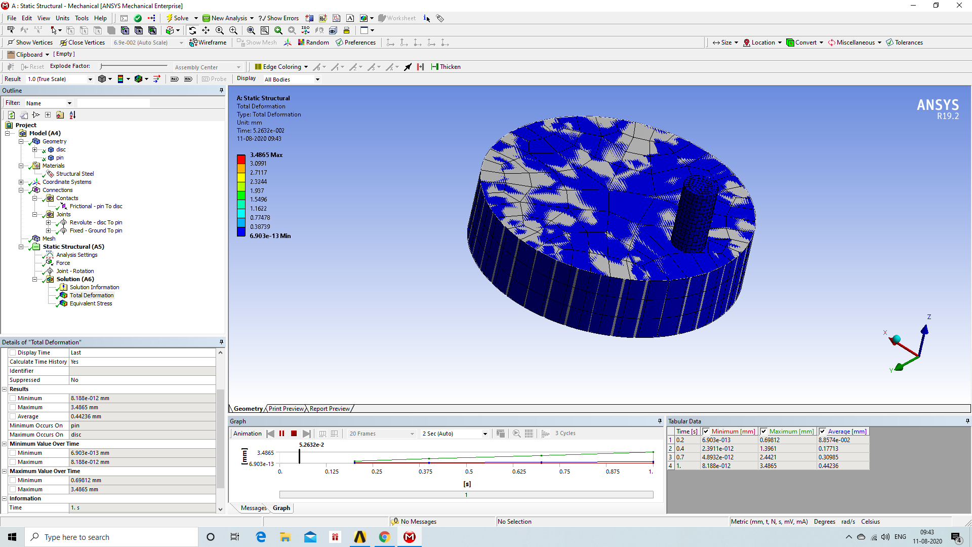

in the solution part pin deformation is coming more than disc. in reality this is not the case.
also in the eq stress part, only pin stress it is showing and not of disc.

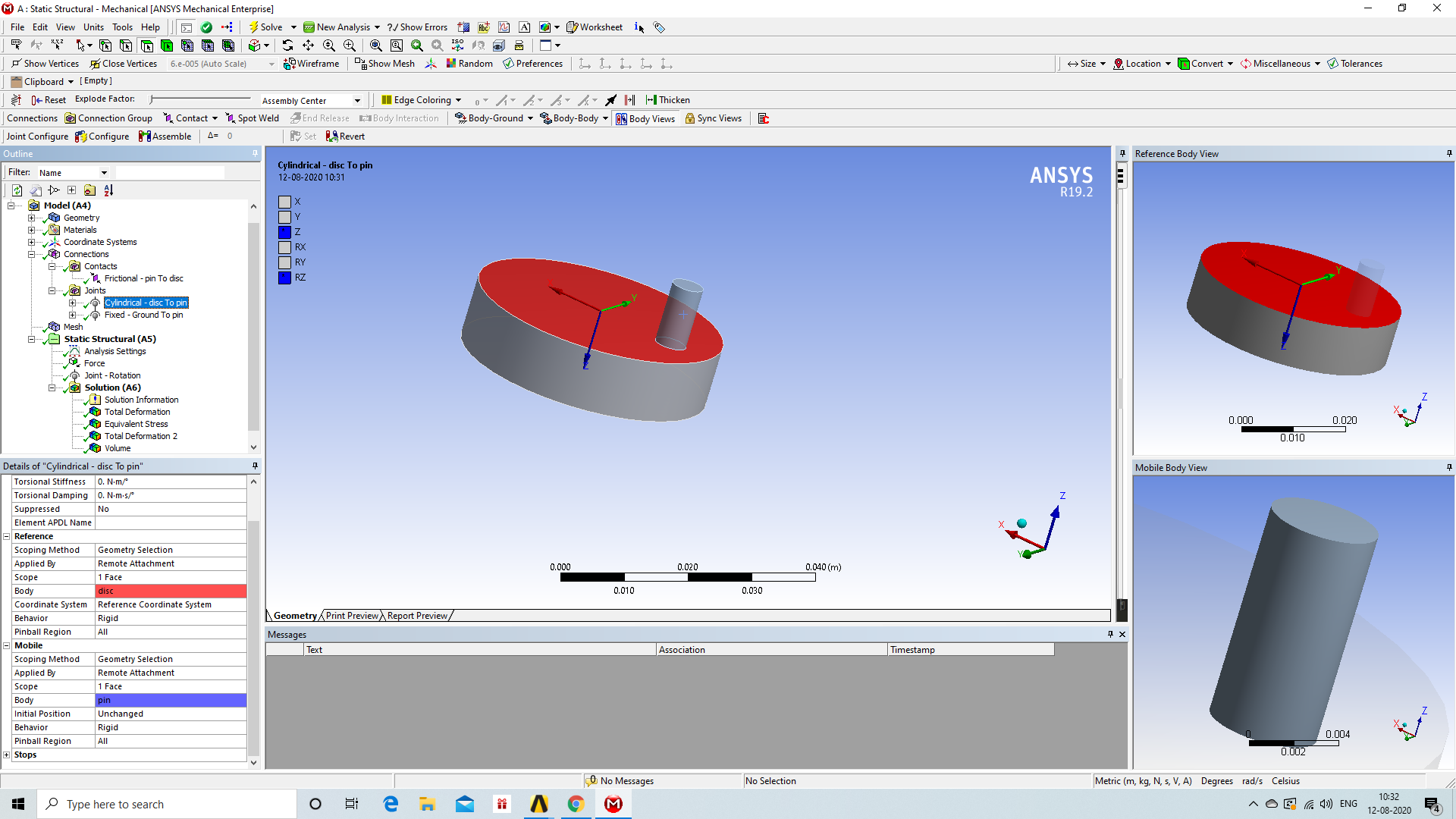

Ansys EmployeeHello,nLet's see if we can help out. I think what is happening is your revolute join of disc to pin. The revolute joint has only rotation about Z degree of freedom. If it is scoped on the pin, the pin won't translate in Z, assuming if you force is pushing in the Z direction. A cylindrical joint does have Z degree of freedom, so maybe you just need to change the joint from revolute to cylindrical. Can you try that? Thanks.nnSean HarveynAugust 12, 2020 at 5:05 ambittus
SubscriberHello,nnthank you for your response.nthe results are same, no changes are seen even after changing re volute to cylindrical. nALSO, To make myself clear i have selected stiffness behavior of disc as rigid and pin as flexible in geometry. nand top of pin is fixed, and there the force is being applied.nnkindly advice nthe model that i am trying to simulate roughly looks like thisn

Ansys EmployeeHello,nOk, thanks for clarifying. If you make the disc rigid, then the disk is idealized as a rigid body with 6 DOFs, so you will not see any elastic deformation. If you wish to model the above system in the drawing, then I just would like to ask why the disc is made rigid? Ansys Mechanical won't show stresses on a body that has behavior set to rigid.nThank you.nRegards,nSeannAugust 12, 2020 at 10:19 ambittus
SubscriberHello sir,nnThe disc and pin were by default rigid (model>geometry>stiffness behavior>rigid). I just made pin flexible, to get more deformation study on pin. but the deformation behavior were more on disc than pin in both the cases.nAlso, I want to picture what is happening at the contact point when the model is running. How to i make the disc transparent so that i can view from below? ndoes ansys provide the way to study the stress at contact area?.RegardsnAugust 12, 2020 at 10:41 pmSean Harvey

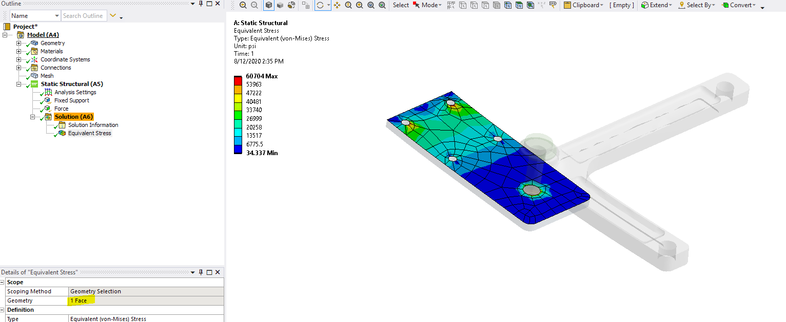

Ansys EmployeeHello again!,nThanks for clarifying. Parts brought in from CAD default to flexible behavior. For the model you are simulating you would want both to be flexible. To see through the disc you can scope the results to just the pin, and the disc will show somewhat transparent. For example.nnHere is my assemblynnHere i scoped to just a face (could be body, etc.) but I can see the stress through the other partnn
nTo look at the stress between the parts, you right mouse button on Solution and pick Contact Tool, then right mouse button that contact tool object and you can insert many results like status, pressure, gap, etc.nnKeep in mind to capture the behavior, depending on how high your force is, you will potentially need a fine meshnThank you.nSea

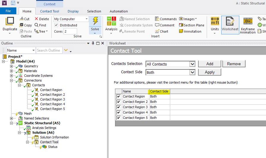

Subscriberthank you sir for ur response.nit has really helped me.nComing to the contact part of solution, when i donot get the pictorial representation. only the graph results are shown. is there a way to get pictorial representation which diff color contour as we get for other results like stress etc?.nAugust 14, 2020 at 5:27 pmSean Harvey
Ansys EmployeeHello,nYou are welcome. When you insert the contact took, and then right mouse button and insert pressure, you can use that to understand the normal contact pressure/stress. Likewise since you have frictional contact, you can insert frictional stress to see that result. Keep in mind the result is shown on the contact side of the pair, which your your case should be the pin. In the contact details you should set the behavior to asymmstric and confirm the contact side is the pin.nPlease watch this video on proper designation of contact/target If you wish to see the contact results on the disk, you change behavior to symmetric and you will get two pairs of contact. We also discuss that in this video. It may get confusing when you have two results on top of one another, so in the contact tool you can change the contact side from both to contact or target side to see results on just one side or the other. The results of the contact when you have two on top is generally the average of those results, but keep in mind a course mesh, you may see wide variation, so again, it may come down to what you are trying to capture, and your mesh resolution.nnnnRegards,nSeann

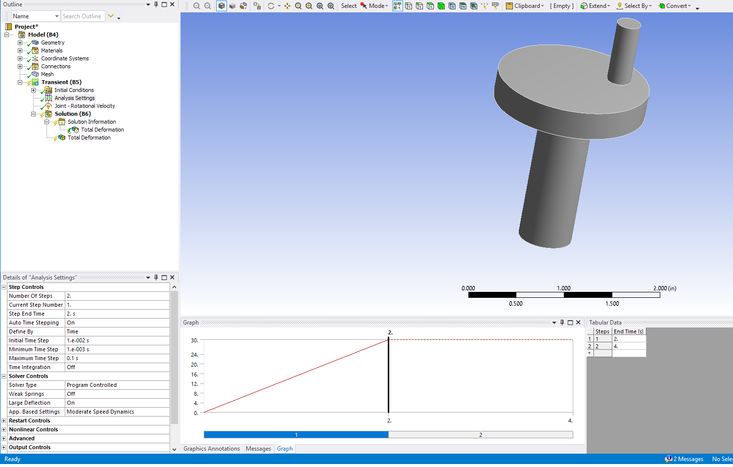

SubscriberHello sir,nnSo the simulation works when i give rotation in terms of degrees. However, i want to give the input in terms of Rotational velocity(rad/s).n Is there way i can do that?.the reason i am asking this because, i have run experiment with disc rotating at 300 rpm for 30 minutes. i want to replicate the same in ansysnnRegardsnSeptember 10, 2020 at 7:24 pmSean Harvey
Ansys EmployeeHi there. My apologies on a delay. You can set this up as transient structural, and then specify the joint rotation to be in rotational velocity. Since you likely don't care about the dynamics you will want to turn off the time integration (as shown in the details). Also, don't for get to turn on large deflection. Please try this. Thank you.nnSeannn
