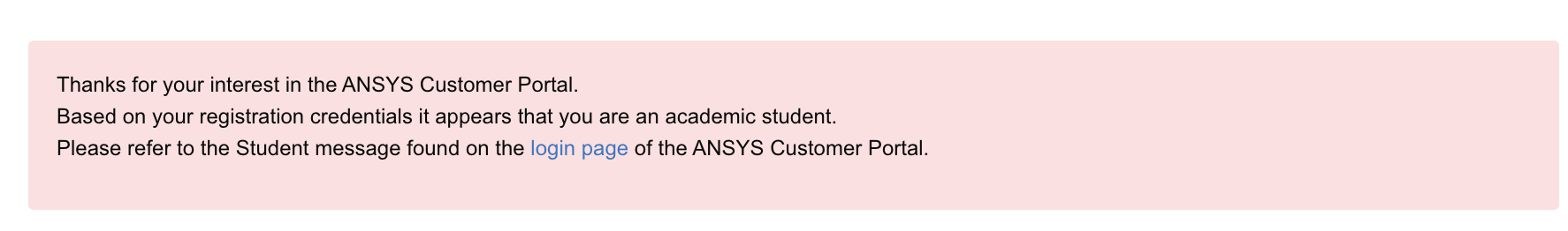

Is there other way to access the page? The link directed me to the login page and asked me to complete the registration. After I filled out everything and submitted, I got the following message. Then I clicked on the login page and had to fill out again. The message popped up again, and thus I couldn't access the page.
Thank you.
