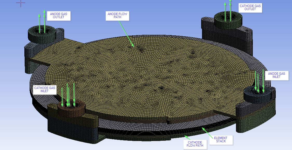

      Thanks for the reply. Below is an image of the fuel cell I was attempting to run. The gas flows into/out of the small cap-like circular bodies and the gas flows over (anode) and under (cathode) the element stack in the middle. I have since updated the geometry to simplify it by removing parts of the flow channels that don't contribute to the reaction.
      Old geometry (meshed) shown below. The geometry below is a multi-part assembly with each part sweep meshed with contact regions to link all the parts.

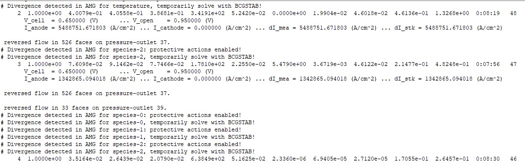

      Errors encountered when running the solver (fuel cell module):
      Error Messages (Old Geometry)
      Most of the errors I was seeing were the divergence detected for the various species and the reversed flow at the outlets.

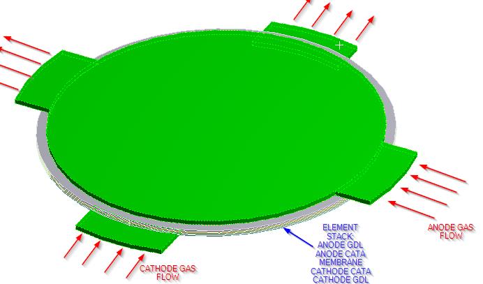

      After the solver failed, I tried making some changes to the geometry to simplify the bodies. I eliminated the vertical members with the circular tops (gas inlets/outlets) and trimmed the gas flow paths to be as short as possible. At the moment, I'm finished with the geometry but have not yet completed the meshing. My plan is to make the assembly a multi-body part to achieve conformable meshing.
      NEW GEOMETRY:
      NEW GEOMETRY
      I have two specific questions that I can use some help with:
      1. Along with the simplified geometry, I'm attempting to make sure the mesh is both conformable and swept to maximize quality and efficiency. Do you know if the fuel cell module requires a conformable mesh to function? Or are defined contact regions permitted?
      2. I read an article that suggested that shadow wall pairs showing up in the solver should be eliminated. Would you be willing to help me understand that a little better? Do we need any shadow walls or should they all be deleted in the solver?

      I'm not sure about the fuel cell model, but having a conformal mesh is likely to help. You also need to make sure you have 10+ cells across a flow channel and that the cell quality is good.
      A wall - wall:shadow pair means you have a thin wall. Ie the wall is a single surface and has cells on both sides. They're not "good" or "bad", they're just part of the boundary definitions. If you need to you can give a coupled wall a thickness in the solver for heat transfer purposes.
