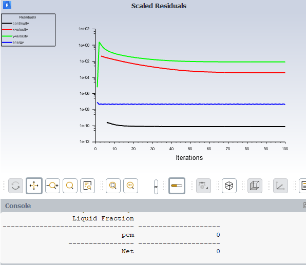

SubscriberFebruary 21, 2021 at 6:00 pmSurya Deb
Ansys EmployeeI believe this is a transient simulation, how long have you run it?nDo you have an estimate of the thermal diffusion time scales?nMay be the heat has not diffused inside the domain yet.nI would also suggest you to refine your mesh near the walls to capture the gradients properly.nRegards,nSDnViewing 1 reply thread- The topic ‘PCM SIMULATION’ is closed to new replies.
