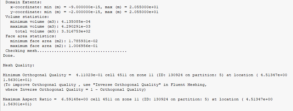

      I would like to simulate the melting of ice. For this I have created a 2-dimensional transient model. The model represents ¼ of a circle. Unfortunately it comes very often to the error "Error at Node 0: floating point exception" I have already googled but could not find a solutin. Attached are some pictures from Fluent and I've coppied some text from the Console. Can anyone tell me what settings I have to make so that the error no longer occurs and the model calculates cleanly?

      As you may have seen in the rules, staff are not permitted to open/download attachments so please re-post the images. nThe error suggests the solver diverged, so check mesh quality, boundary/cell conditions and models. How do the residuals look prior to the failure? n

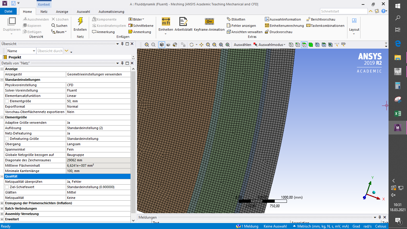

      Cell quality looks OK, have you got good refinement of the mesh? What time step did you use, and what is the material density?n
    • cfdjannis

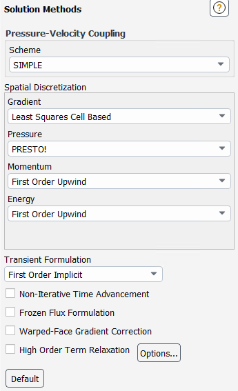

      Thank You for your answer Bob. n nWhat do you mean with refinement of the mesh?nI will attach a picture of the meshing-tool.nI've also tried to activate and disable adaptive size but it doesn't changed something. I've tried a lot with the time steps. I've used one second up to one minute….n nFor the density of water I‘ve used the "piecewise-linear" function. nAnd for the solids and the air I’ve used a fixed value.
      If the density of water varies, where does the extra volume go? n
